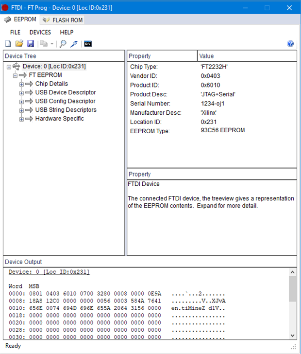

    1.   Did you configured the F <BOOT> J connector correctly to emulate JTAG ?
    2.   Did you chek the device manager in Windows and lsusb in Linux to see if the FTDI chip is being recognized ? (You can download the FTDI chip reconfiguration tool for windows and check the FTDI connections. BUT DO NOT WRITE ANYTHING BACK AS THEN YOU WILL PROBABLY BRICK YOUR KIT)
    3.   Check that Proper FTDI Drivers are installed before hand.

    1. Yes, and I have tried both configurations many times. According to the reset guide I should boot from the flash, so that is what I did to produce that output, but it is the same output with both actually.
    2. Yes, I checked that now and it is being recognized as "USB Serial Port (COM19)". Can you send me a link for the FTDI reconfiguration thing, if that is still important? I am not sure how to find that myself.
    3. Yes, as far as I can see, all the drivers are installed successfully on my computer. I would just mention that I used to communicate perfectly with it before I accidentally unplugged it.

    Sorry for late reply, I am uploading my configuration file and linking the Programming software https://www.ftdichip.com/Support/Utilities.htm#FT_PROGimage
    Sorry I am not sure weather this editor is allowing me to upload the files, email me [Pl Visit gsgill112.github.io] and i will forward that. Though I am not sure how helpful will that be

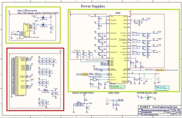

    1. Try using a multimeter, get a schematic and poke around the USB and the PMIC section to verify the correct voltages.
    2. If you dont have a multimeter a crude way is using a led with some 100Ohm resister in series stick the -ve terminal to ground and start probing the 3v3 / 5v Rails.
    3. With a multimeter check for VCC to Ground Shorts ( you can also touch components and feel is one of them is burnt or is getting really hot)
    4. If all of the above tests have failed, You can try powering the board from 3v3/ 5v  rails on the PMOD  to check if at least the power led turns on and nothing get the magic Smoke or overheats.
    as per the a/m tests we can try and figureout what is wrong with the board that is.

    I think it was very hard to understand much of what you said, but I have tried a few things:
    Firstly I downloaded the program you linked and pressed "scan and parse" and got the exact same configuration and output as you. Then I randomly tried the "program" button and think I reprogrammed it, and the configuration was still the same, but slightly different output. It doesn't seem like it fixed the board either. All LEDs still just light up like before boot.

    1. I got this schematic: http://zedboard.org/sites/default/files/documentations/MiniZed_Rev_1_Schematic.zip and tried measuring voltage from GND to PMIC_GPIO3 and from GND to PMIC_GPIO4. Both voltages were 0. I also measured from GND to VBBAT and that voltage started out around 3V but immediately started decreasing when I measured it and soon got very close to 0V. I don't know really what this means, for my board, hope you can help a bit here... I also don't know how to interpret what I measured on the USB section: There the FT_PWRSAV_N has 0V, which was the only pin I could find accesible on the board.
    2. I have a multimeter. All constant voltage pins I could find also have the voltage that is written on them.
    3. I can not find any shorts from GND to a not GND pin. I can not see any very burnt or feel any very hot components.
    4. Ok, maybe interesting... I tried powering the board only from PMOD using 3.3V and all LEDs light up, including the blue one (DONE) which is not lighting up when powering from USB. I can not see any smoke, but after only 5 seconds my power supply (a digilent analog discovery 2) cuts of due to overcurrent.

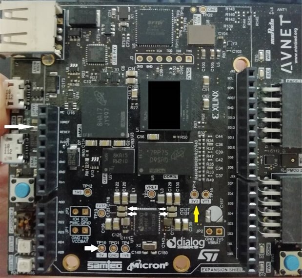

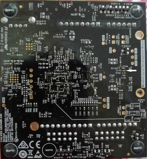

    Firstly,
    We will try to ascertain if the main power path is continuous OR not. I.e Power is reaching the main Dialog chip or not.
    To do that see the White arrows in the First and the Second Images, all of them corresponds to 5V from the Aux Input that is the CLOSEST to the PS BUTTON.
    (DONT POWER YOUR BOARD AT THIS TIME ) Just fix one of your multimeter ends to TP16 (5V is written there) and sequentially probe other white marks with other leads IN CONTINUITY MODE. If you hear a beep from Multimeter, its good, go to next one.
    Assuming that there is continuity moving on
    Secondly,
    We Will probe the Input Power Signals (DO THIS CAREFULLY) as a wrong touch to other component will definitely kill the PMIC .
    To be safe we will only probe 2 places i.e. D13 the Big Diode near the Aux Power USB Source. and the TP16
    So, first connect the Black /COM probe to GND (anywhere) or just connect it to TPG1( GND Written there ) and set it to Voltage Mode with 20V range
    connect power to the Aux USB Port.
    second : probe D13 at the point just below the usb connector (without the Grey band) your multimeter should read ~5V DC.     :     IF you read a 0 here most likely there is a issue with solder joints on the USB port / D13 might be off.
    now probe the other part of the diode i.e the place with Grey band (Marked on the above images ) and you should still read 5 V DC.      :     IF you read a 0 here most likely there is a issue with  D13 and it has been blown. Most likely due to ESD.
    now probe the TP16 point. You should get 5V DC,      :     IF you read a 0 here most likely there is a issue D13 as mentioned above or some of the small Capacitors protecting the Input side of the PMIC might be off.
    IF at any given location the voltage is fluctuating, then most likely the Caps are to be blamed and that may be  beyond a beginner to diagnose or fix.
    IF D13 is short or the Input filtering caps are gone, most likely, PMIC might have suffered some blow and that can be partially diagnosed by checking the Output side.
    Now with this Knowledge , try diagnosing the Output side, start by the 3.3V in the similar fashion  which is the Main power rail to all other ICs on the board.
    Start with continuity testing on the signal marked by yellow in the above image and refer the datasheet screenshot attached.
    NOTE : probe only the GREEN BOXES marked in the schematic to save time , the red ones are most likely not the culprit (but can be ) So Happy Hunting.

    sigurdht over 6 years ago in reply to gsgill112
    Thanks again for helping, and sorry it took a few days before I tested this.
    Firstly,
    The multimeter beeped nicely on all connections from TP16 to the components you pointed at in the pictures.
    Secondly,
    I connected the aux pwr USB and measured voltage from the side without grey band and got 4.90V, and on the grey band side I got 4.68V. And at TP16 I measured 4.68V. So, I guess this part is all good. None of the voltages are fluctuating.
    When it comes to the output side I am not sure if I found all the connections to check, because I only found TP14 to R110. But I checked that one, and it was all good.
    But is it possible that it is a short from any of the power signals, when they all have the correct voltages when powered by USB? I know I get overcurrent when powering only 3.3V directly on the 3.3V pin (or the PMOD, which is just directly connected to 3.3V), but if I do that while the board also is correctly powered from USB, there is no overcurrent.
