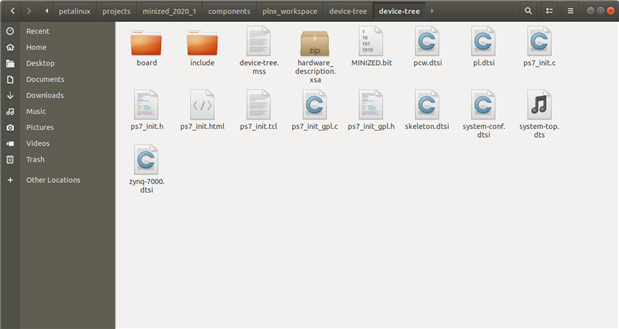

Just doing the started petalinux commands; I got the sources from AVNET Github
Petalinux-build -c avnet-image-full gives me the following error:
bluetooth_uart and axi_iic seems to be the problem, anyone can help me out? It uses the standard bsp for minized from AVNET (github). (tools used: 2020.1)
Thanks

    On default project (without fpga manager) you are appending this to pl.dtsi generated by petalinux: This is default pl.dtsi /* * CAUTION: This file is automatically generated by Xilinx. * Version: * Today…
  • bartokon
    bartokon over 6 years ago

    You know axi_iic0 and bluetooth_uart, are located in PL-side of ZYNQ. Now you are modifying  bluetooth_uart: serial@43c00000  node adding some new data to device-tree
    Now let's turn on FPGA manger and device-tree overlays.
    Now pl.dtsi looks like this:

                    clock-names = "s_axi_aclk";
                    clocks = <&misc_clk_0>;
                    compatible = "xlnx,axi-intc-4.1", "xlnx,xps-intc-1.00.a";
                    interrupt-controller ;
                    reg = <0x41800000 0x10000>;
                    xlnx,kind-of-intr = <0xffffffff>;
                    xlnx,num-intr-inputs = <0x20>;
                bluetooth_uart: serial@43c00000 {
                    clock-frequency = <0x2dc6c00>;
                    compatible = "xlnx,xps-uart16550-2.00.a", "ns16550a";
                    current-speed = <115200>;
                    device_type = "serial";
                    interrupt-names = "ip2intc_irpt";
                    interrupt-parent = <&intc>;
                    interrupts = <0 29 4>;
                    port-number = <1>;
                    reg = <0x43c00000 0x10000>;
                    reg-offset = <0x1000>;
                    reg-shift = <2>;
                    xlnx,external-xin-clk-hz = <0x2dc6c00>;
                    xlnx,external-xin-clk-hz-d = <0x30>;
                    xlnx,has-external-rclk = <0x0>;
                    xlnx,has-external-xin = <0x1>;
                    xlnx,is-a-16550 = <0x1>;
                    xlnx,s-axi-aclk-freq-hz-d = "100.0";
                    xlnx,sim-device = "VERSAL_AI_CORE_ES1";
                    xlnx,use-modem-ports = <0x1>;
                    xlnx,use-user-ports = <0x1>;
                xadc_wiz_0: xadc_wiz@43c10000 {
                    compatible = "xlnx,xadc-wiz-3.3", "xlnx,axi-xadc-1.00.a";
                    interrupts = <0 32 4>;
                    reg = <0x43c10000 0x10000>;
                    xlnx,alarm-limit-r0 = <0xb5ed>;
                    xlnx,alarm-limit-r1 = <0x57e4>;
                    xlnx,alarm-limit-r10 = <0x5555>;
                    xlnx,alarm-limit-r11 = <0x5111>;
                    xlnx,alarm-limit-r12 = <0x9999>;
                    xlnx,alarm-limit-r13 = <0x91eb>;
                    xlnx,alarm-limit-r14 = <0x6aaa>;
                    xlnx,alarm-limit-r15 = <0x6666>;
                    xlnx,alarm-limit-r2 = <0xa147>;
                    xlnx,alarm-limit-r3 = <0xca33>;
                    xlnx,alarm-limit-r4 = <0xa93a>;
                    xlnx,alarm-limit-r5 = <0x52c6>;
                    xlnx,alarm-limit-r6 = <0x9555>;
                    xlnx,alarm-limit-r7 = <0xae4e>;
                    xlnx,alarm-limit-r8 = <0x5999>;
                    xlnx,alarm-limit-r9 = <0x5111>;
                    xlnx,configuration-r0 = <0x0>;
                    xlnx,configuration-r1 = <0x21a0>;
                    xlnx,configuration-r2 = <0x400>;
                    xlnx,dclk-frequency = <0x64>;
                    xlnx,external-mux = "none";
                    xlnx,external-mux-channel = "VP_VN";
                    xlnx,external-muxaddr-enable = <0x0>;
                    xlnx,fifo-depth = <0x7>;
                    xlnx,has-axi = <0x1>;
                    xlnx,has-axi4stream = <0x0>;
                    xlnx,has-busy = <0x1>;
                    xlnx,has-channel = <0x1>;
                    xlnx,has-convst = <0x0>;
                    xlnx,has-convstclk = <0x0>;
                    xlnx,has-dclk = <0x1>;
                    xlnx,has-drp = <0x0>;
                    xlnx,has-eoc = <0x1>;
                    xlnx,has-eos = <0x1>;
                    xlnx,has-external-mux = <0x0>;
                    xlnx,has-jtagbusy = <0x0>;
                    xlnx,has-jtaglocked = <0x0>;
                    xlnx,has-jtagmodified = <0x0>;
                    xlnx,has-ot-alarm = <0x1>;
                    xlnx,has-reset = <0x0>;
                    xlnx,has-temp-bus = <0x0>;
                    xlnx,has-user-temp-alarm = <0x1>;
                    xlnx,has-vbram-alarm = <0x0>;
                    xlnx,has-vccaux-alarm = <0x1>;
                    xlnx,has-vccddro-alarm = <0x1>;
                    xlnx,has-vccint-alarm = <0x1>;
                    xlnx,has-vccpaux-alarm = <0x1>;
                    xlnx,has-vccpint-alarm = <0x1>;
                    xlnx,has-vn = <0x1>;
                    xlnx,has-vp = <0x1>;
                    xlnx,include-intr = <0x1>;
                    xlnx,sampling-rate = "961538.4615384615";
                    xlnx,sequence-r0 = <0x4f01>;
                    xlnx,sequence-r1 = <0x0>;
                    xlnx,sequence-r2 = <0x0>;
                    xlnx,sequence-r3 = <0x0>;
                    xlnx,sequence-r4 = <0x0>;
                    xlnx,sequence-r5 = <0x0>;
                    xlnx,sequence-r6 = <0x0>;
                    xlnx,sequence-r7 = <0x0>;
                    xlnx,sim-file-name = "design";
                    xlnx,sim-file-rel-path = "./";
                    xlnx,sim-file-sel = "Default";
                    xlnx,vaux0 = <0x0>;
                    xlnx,vaux1 = <0x0>;
                    xlnx,vaux10 = <0x0>;
                    xlnx,vaux11 = <0x0>;
                    xlnx,vaux12 = <0x0>;
                    xlnx,vaux13 = <0x0>;
                    xlnx,vaux14 = <0x0>;
                    xlnx,vaux15 = <0x0>;
                    xlnx,vaux2 = <0x0>;
                    xlnx,vaux3 = <0x0>;
                    xlnx,vaux4 = <0x0>;
                    xlnx,vaux5 = <0x0>;
                    xlnx,vaux6 = <0x0>;
                    xlnx,vaux7 = <0x0>;
                    xlnx,vaux8 = <0x0>;
                    xlnx,vaux9 = <0x0>;
    But using the same Avnet device-tree you can't modify this new pl.dtsi with petalinux (Yet i think).
    Easiest way is to take this ^ device-tree fragments modify it by hand and generate device-tree overlay that you put into already live-device-tree that exists on running Minized.
    Use this as a template for PYNQ: https://www.hackster.io/bartosz-rycko/minized-2020-1-getting-started-pynq-b39925, and generate new device-tree overlay with PYNQ-PRIO Thishttps://www.hackster.io/bartosz-rycko/eclypse-z7-pynq-porting-guide-3dd24c.
    in petalinux type something like this "fpga-util -o my_overlay.dtbo" This should put new overlay and probe all devices. You can face this error: https://discuss.pynq.io/t/pynq-device-tree-overlay-zmods/1861/2  so best thing is to change interrupts registers for bluetooth and iic.
    Quick note, this should  work but it is not tested by any means! I think this should give you some tips what to do next.
    cheers
    -BR
