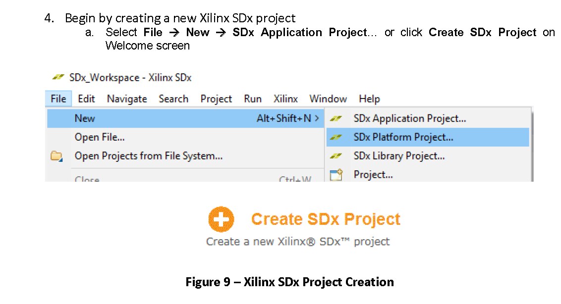

    Hi
         I just installed the SDSOC 2018.3 and downloaded the bare metal Matrix multiply 2018.3 from the Minized reference design page. However, I concur
    the PDF file is not updated with the latest menu's/pull down actions from the SDSOC 2018.3.
    Change the blue highlighted "SDx Platform Project' --> SDx Application Project.  The text description in  step 4 should also say Application in all places to be clear to the reader.
    I initially went with the platform project and ended up messed during steps 13/14. I retraced my steps and found that step 4 figure needs to be fixed correctly to app project.
    Thanks
