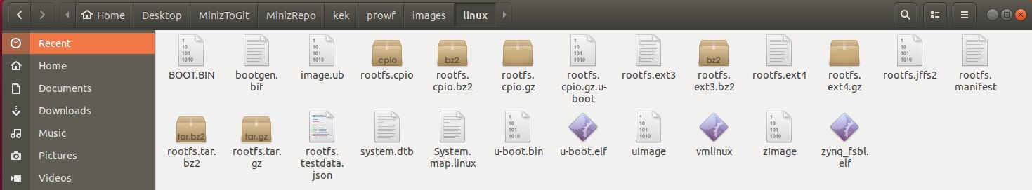

Hello everybody!
I have tried to create Minized Platform for SDSoC 2019.1 but with no luck.
I have imported and updated Minized project with Wi-Fi and BT hardware, upgraded ip's eliminated errors, generated hdf file for platform.
Created petalinux project via.
petalinux-create -t project -n name --type zynq
petalinux-config  --get-hwdescription=/home/.../.../file.hdf
petalinux-build
no errors occured and i have moutned rootfs.ext4  and
petalinux-package --fsbl zynq_fsbl.elf --u-boot u-boot.elf (something like that) and created BOOT.BIN file then modified *.bif file and changed according path to files listed.
Now in SDSoC create project from hw-spec
DSA/HDF file =/home/.../.../file.hdf, system linux etc.
And now I have tried two ways....
One is generated all by SDSoC and other one is pointing ready files location and none of them works (I cannot see those platform when creating new project in SDSoC).
Now I don't know what to do.... Do you guys/girls have any idea why it isn't working?
Thanks for help

  • clem57
    0 clem57 over 7 years ago
    Was a tree generated in those steps? The tree is like a hardware descriptor used by kernel code
  • bartokon
    0 bartokon over 7 years ago in reply to clem57
    "System.dtb" exists in images folder.
    I think it's a problem with SDSoC... I tried to create zc702 clean project by inserting only zynqPS and exporting HW. Still, same result... I don't know if is this licensing issue or something
    Now I'm uploading whole MiniZed project to git (I know it is bad idea ~40gb) but there is a hdf "pswifi.hdf" file for project. If you need any logs or files just tell me.
    Thanks for being interested and helping us image
