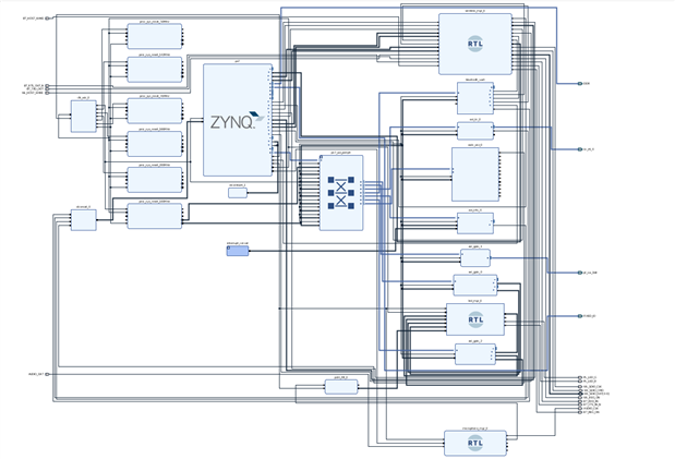

I was curious what the actual block diagram was for this, so I extracted the BSP and found the xpr (Vivado project) and opened it up and saw this:
I had a couple of questions from this point:
1. So I wanted to start small, and try controlling the PL_LED_G and PS_LED_R from the Linux operating system (just to get my feet wet) by writing some C code.
So, from the root of the petalinux BSP package (the directory where I see the folders components, project-spec, pre-built, etc.) I tried doing:
petalinux-boot --jtag --prebuilt 3
Because I wanted to boot into the linux OS through JTAG. I was able to boot up successfully but I don't think I have any of the gcc tools on my environment. Do I need to run petalinux-build and change some settings?
2. I also see videos where I can make a platform package in Vitis and I can test run C code (perhaps to do my controlling of PL_LED_G and PS_LED_R) from that but I'm not too sure how to make a platform package in Vitis by using the BSP I downloaded.
Thanks for the help!
Prateek
