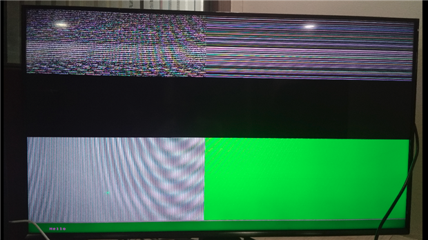

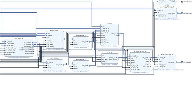

We are developing demo Application for Picture in picture. for this we are using PicoZed 7030 board with FMC HDMI daughter card. We are referring FMC-HDMI-CAM + PYTHON-1300-C Reference Design Tutorial from zedboard.org. In this project Video On-Screen Display (OSD) Ip produces output video from external video sources (i.e HDMI,Camera input) and internal graphics controller.
In Vivado we used Axi vdma to read image from sd card . Inside Sd card we have used .bin file which is converted from .jpg image.
Following is the snippet of block design.
But we are not getting proper result over display.
We are not sure about which image format to place in Sd card to get proper result over the display. Is there any thing we are missing?

    Based on your block design, you seem to be using 32 bit pixels.
    Xilinx usually packs this as XRGB, where the top 8 bit are unused (or an alpha channel, if supported).

    We want to read image from sdcard and display using osd layer. we are using  following chain
    SDCARD --> AXI VDMA(24bit data width) ---> RGB2YCBCR(video_in 24bit) ----> CHROMA resampler(YCbCr444 to Ycbcr 422)----> OSD layer( video format yuv422) ---> HDMI OUT
    We are using bare Metal application Over Zynq to Read from SD Card. RGB values for a picture (.bin format) are stored in SDcard. Any clue here to read .jpg/.bmp/.png image from sd card using baremetal application.

    We tried this reproduce on 8, 16,24 and 32 bit pixels. With this problem remains the similar. The colour which have repeated pattern like 0x00000000(black), 0x80808080(gray),0xFFFFFFFF(white) are reproduce proper all bit pixel format.so seem some different issues with may be RGB2YCBCR or Chroma resampler IP's.
    Any inputs
    Regards
    shantaram

    Can you please plot the full screenshot of block design?
