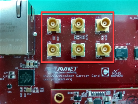

Hello all,
I wanted to make you aware of an errata change to the Version 1 of the PicoZed FMC Carrier Card.
If your serial number is between 1450530‐1450629 there is a possibility that you have the wrong connectors installed for the SMA transceiver path.
We are providing three options to assit with this issue.
  •   If you are not working with the transceivers, these connectors are not used, no action required
  •   Use the connectors as‐is with an SMB cable.
  •   Return the board to Avnet for connector replacement.
You can find the entire errata located http://picozed.org/support/documentation/4701
under Hardware Guides.  Search for "PicoZed FMC Carrier Card Rev C Errata"
--Dan

    Hello all,
    For reference, here is an example of this mispopulated SMA Connectors.
    --Josh
