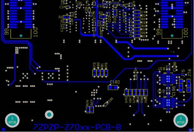

I tried to spot JT5/JT6 on the front/back view of the 7015 SOM, because I think that it would be very benefitial to be able to switch between the eMMC and the MIO pins on JX2 via software.
One candidate for such a purpose would be the otherwise unused PS_MIO8, connected to R85 which I think I found on the bottom side right beside the FPGA breakout.
I wasn't able to locate U18 and U19 either on the images, so any hint where to look for those would be appreciated.

    The default jumper positions from the factory allow SW control of the MUXs by default, JT5 and JT6 in position 1-2. PS_MIO0 is the I/O pin used for the MUX select.
    Here is a snapshot of the locations you are looking for. Back side, lower right corner:
