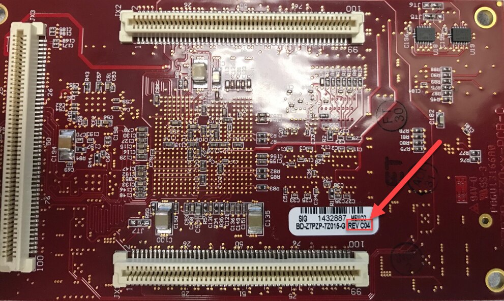

    What PicoZed 7015 revision are you using? You clarified which version, but not which revision. You can determine which revison you have by looking on the back side of your PicoZed and looking at the white sticker. For instance I have the C04 revision.

    My PicoZed 7015 revision is BD-z7pzp-7z015-G REVC. I am using Vivado 2015.4.  As I said  I want to know if my board only support 100M Ethernet operation rather than 1000M Ethernet , how should I Create Block Design. Please help me.
