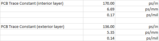

    I personally don't use those formulas, but they sound right image. PCB manufacturers will give you the PCB flight time based on your material, copper weight, thickness, etc. A board that I analyzed in the past had the following characteristics (given to me by the PCB manufacturer):
    I found this useful article on LinkedIn
    https://www.linkedin.com/pulse/signal-speed-propagation-delay-pcb-transmission-line-amit-bahl/
    Knowing that Isola 370HR is a type of FR4 with Er = 4.0, my parameters above are very close to what the write describes in that article with microstrip (exterior layer) Tpd = 145 ps/in and stripline (interior layer) Tpd = 170 ps/in.
    For the very best numbers, consult your PCB manufacturer with the specific parameters of how you intend to build your board. If your goal is approximating, then the numbers above may be used.

    Sorry it wasn't more clear. Those numbers above were for MicroZed, and PicoZed was identical in material and technology to MicroZed, so the numbers are the same. Therefore, for PicoZed I would use 170 ps/in for stripline and 136 ps/in for microstrip.
    I have not updated the Excel file yet to do the mapping. With Xilinx Adapt going on this week, my schedule has been quite busy.
