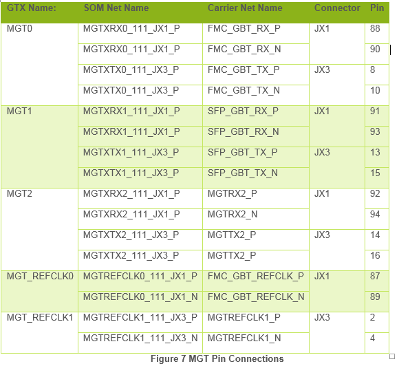

     Specifically I'm looking for where each of the SMA RF connectors map to the PicoZed SDR module.

    It may save you some time looking at the FMC Carrier and SOM schematics to see the table below which will be in the FMC Carrier User Guide.
    Also the SMAs are as follows:
    •   J1 = alternate clock input to the AD9361 (AD9361_CLK)
    •   J2 = carrier clock synthesizer chip (AD9517) output; same clock sent to Zynq MGT bank as reference
    •   J3 = Zynq MGTTX2_N (inc.DC blocking capacitor)
    •   J4 = Zynq MGTTX2_P (inc.DC blocking capacitor)
    •   J5 = Zynq MGTRX2_N
    •   J6 = Zynq MGTRX2_P
    •   J7 = alternate clock ref input to the AD9517 clock synthesizer on the carrier
    The reference design is described in the Getting Started Guide.
