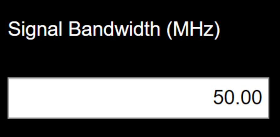

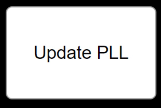

    migration.user over 5 years ago in reply to mbrown
    Hi Matt,
    thanks fur the update. When i say "to update the PLL" i mean the following:
    After changing this value in the GUI:
    I need to push this button to take effect:
    The command line command according to this first picture, i found in your API documentation:
    Avnet_RFSoC_Explorer('DTRX2', <dtrx2_cmd>, <parameter>)
    - TX_IF_signal_BW, parameter = TX signal bandwidth (MHz)
    But I did not found with which command line command i can "Update PLL" as like the button in the second picture, for the BW setting to take effect. This is necessary for every signal where the BW differs from the default 50MHz, so i assume there is an according command line command ?
