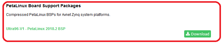

  • zedhed
    0 zedhed over 7 years ago
    The 2018.2 Ultra96 BSP has been posted by Avnet which migrates UART1 routing to the J6 connector and so you should be able to use this BSP to start new designs without having to change the routing on your own:
    http://www.ultra96.org/support/design/24166/156
