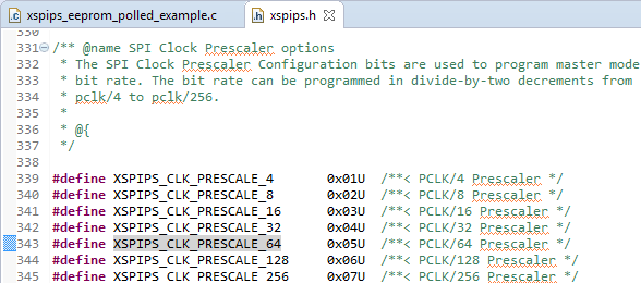

    Hello,
    I am using Microzed board Zynq7020. when I checked My PS frequency for SPI is 166.66MHz. Then as you said I checked XSPIPS.h file but I am not able to find XSPIPS_CLK_PRESCALE function. Can you please tell me what am I missing?
    Thank you
  • jafoste4
    0 jafoste4 over 9 years ago
    Hello Vatsalnaik,
    I was able to find it in the xspips.h file. In Vivado/SDK 2016.2 it is located around line 339.
    --Josh
