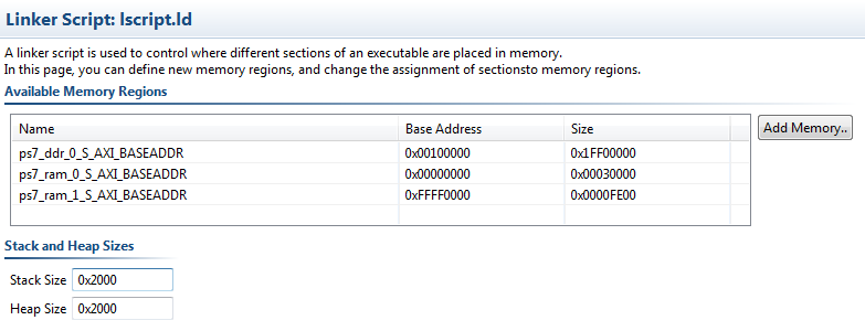

    For example, I just created a new project using the Empty Application template on the build in zed_hw_platform in SDK.  Here are the default stack and heap allocations that SDK creates for you:
    You can see that they are rather small at 2K each, so if you are running a complex application with nested function calls that go rather deep, my suggestion is to check and make sure that you are not overflowing the stack space.  Also, if you are operating on dynamically allocated memory (any space created with malloc() or call to a class constructor) make sure you are not running our of heap space.
    SDK gives you the ability to modify the size of these areas within your lscript.ld file or create a new one using the Xilinx Tools-->Generate linker script window.

    Thanks for your support. Indeed, the amount of memory available in the system was what you commented.
