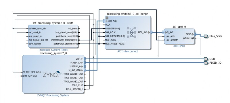

Dear Experts
I need help regarding interrupt handling using UIO. I am using Vivado 2015.4 and Petalinux 2015.4. The board used is Zedboard.
I made the following vivado project attached as image. The interrupts from AXI and Fabric (PL-PS) are enabled.
Afterwards i was able to export it as UIO and it shows in /dev as uio0.
My code is as follows:

But the issue is that this code is not catching the interrupt. Kindly help me in this. Any suggestion/links are more than welcomed
Regards
