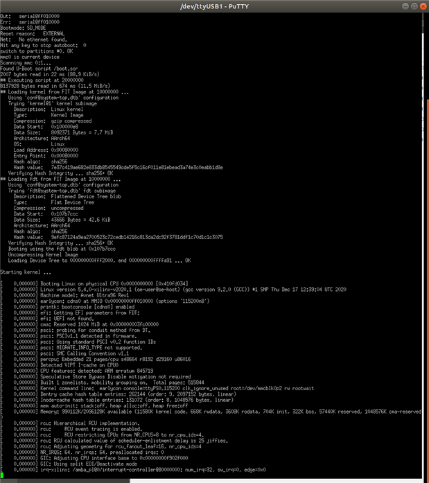

    I am not seeing where anything is being run in that screen shot.  It looks to me that the screen shot is from when the system is still booting up.

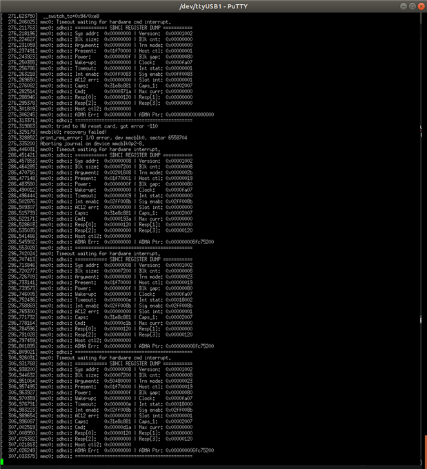

    Hello Daniel! Yes correct it's not even booting as you can see something is wrong with the IRQ. This is happening with your image when I try to boot up (the first screenshot posted).
    With my images (created with Petalinux and Vitis tools of 2020.1) most of the times I boot correctly and try to run the application (yes I Import the xrt before running) but always getting something like this screenshot
    I am not able to understand what I am doing wrong with the Interrupt Controller and what I need to add to Petalinux to trigger the ZYNQ correctly, so it runs the application. As you can see it hangs there waiting for the interrupt to wake up..

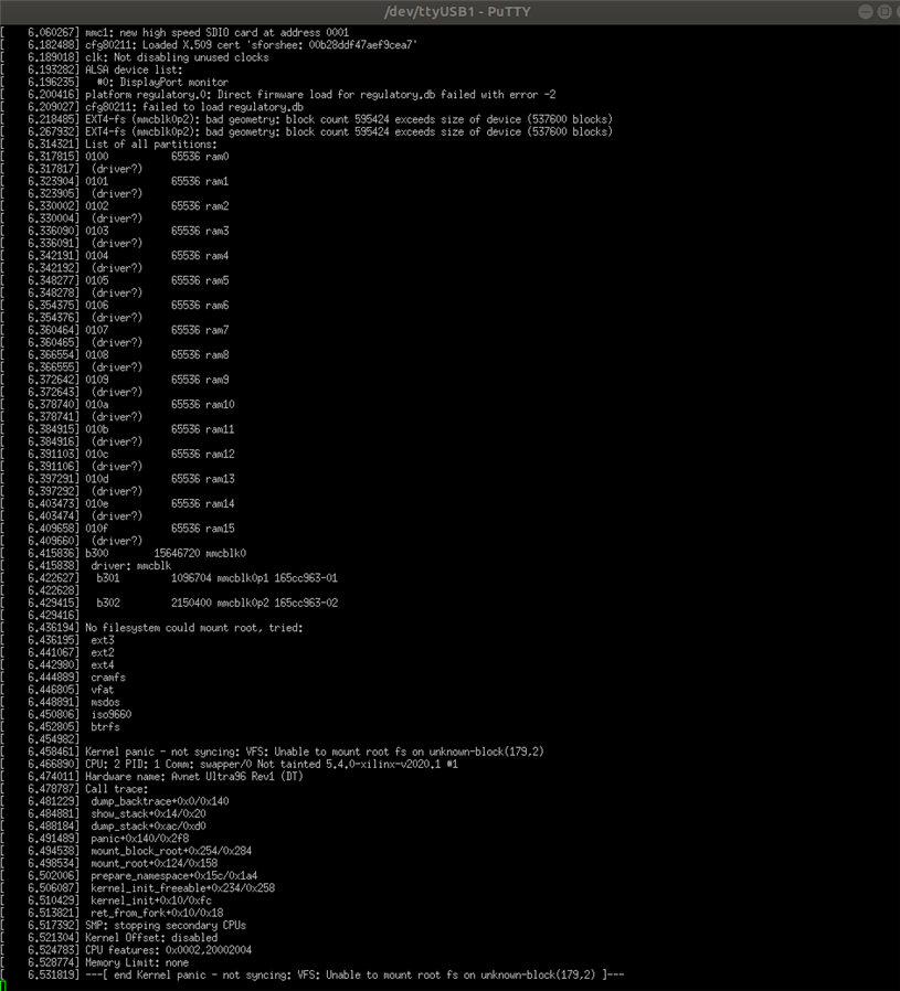

    So we downloaded the image you mentioned , me and a co-worker of mine (different pcs, different devices), and we both faced the same issue.
    The boot is hanging on boot:
    Probably it does not find the rootfs folder. I tried with gparted to extend the 2nd partition (of rootfs), but the problem still exists when I re-write the image.
    Also when I try to access the 2nd partition, it gives me an error "Unable to open disk-partition", so probably the 2nd partition is corrupted or something.

    Are you using the SDCARD that comes with the U96v2 kit?
    Certain brands of SDCARD can have issues.  I find it really strange that you are not booting well - since these are tested images.  They do not get released without being tested as functional.
    Have you verified the MD5 of the downloaded files?  Have you checked your boot switches?
    I have seen the "bad geometry" issue in the past if you do not use a compatible SDCARD.  That is, I used the provided Delkin card without issue. I wrote the same image to another card I had received from Amazon - and that would not boot the SAME image using the other brand.  For what it's worth, this just happened to me 3 days ago.  Please double check the MD5 and that you are using the supplied Delkin SDCARD.

    Also, can you check what fsck says?  I know when my SDCARD was messed up, I saw things like this:
    training@training-VirtualBox:~/projects/ubuntu_z7000$ sudo fsck /dev/sdc2
    fsck from util-linux 2.31.1
    e2fsck 1.44.1 (24-Mar-2018)
    The filesystem size (according to the superblock) is 1919744 blocks
    The physical size of the device is 1914624 blocks
    Either the superblock or the partition table is likely to be corrupt!
    Notice the physical size and filesystem size does not match...in the wrong way (file system looks larger than my sdcard).  I don't think you should see that with the 16GB card, but it is something I noticed on my system.
    --Dan
