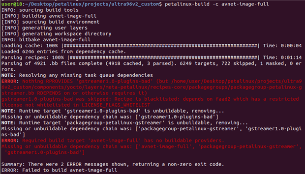

After this, I took the project that was created and trying to build it, and I face this error Petalinux-build error: No kickstart files from WKS_FILES were found , which I finally solved it and running `petalinux-build -c avnet-image-full`. When I try to run `petalinux-build` it still not works.
Now I am trying to add meta-ros layer above of meta-avnet but it gives me errors on the `petalinux-build` command .
Need to mention that meta-ros layer works fine without meta-avnet, and builds successfully if i run `petalinux-build -c ros-image-core`.
So each layer is building fine alone. How I can build both layers together? I am not famililar with petalinux, just started.

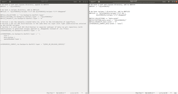

    I downloaded the meta-ros layer from github, then I checkout to zeus branch (as I am using tools 2020.1), then imported the meta-layer in `petalinux-config` after meta-avnet. Also added some packages to the rootfs.config
    Here you can see some of the layer.conf, left is one of the meta-ros layers and right is the meta-avnet.
    I want to build `image-avnet-full` and `ros-image-core`. How can I build both of these in the same build? This is the most important question I need to answer, as they both working alone.
    Also I played with the PRIORITY of meta-avnet and can't get it done. I tried higher values like 7-12 and lower values like 3-4. Still have the same error:
    Need to mention that this error occurs after importing to yocto-layers the meta-ros layers. Before adding meta-ros layers, building of avnet-image-full is successful.
    I see that meta-ros priority has higher-values 10-12, and meta-avnet has 5. So I don't see why this error occurs... Any ideas of how to approach this?
