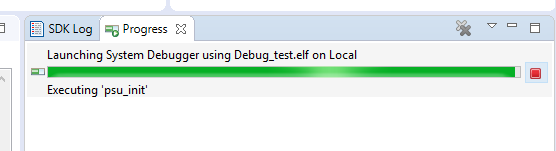

hi all,
i have just received a new ultra96 V2 board and i'm trying to do something
really simple. Just create a zynq block design and run the helloworld application.
i'm using vivado 2018.2. I have installed the Avnet Board Definition Files (BDF) :
ultra96v2 1.0
i have created a block design, inserted a zynq ultrascale+ ip, run block automation.
this is the first test i run when i get a new board.
but when i run the helloworld application, it hangs at :
any idea ?

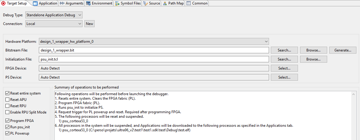

    hi all, i'm using the JTAG/UART Pod to access the USB-UART terminal. i have changed STDIN/OUT to uart1. after some test, i have to : 1) reset entire system, 2) download the bistream to PL, then the psu_init…

    I have had the same problem. After some troubleshooting I found that the psu_init.tcl was hanging in the DDR configuration where it was trying to get information from the board. Someone from Avnet told me that they only saw that when the hardware configuration wasn't right, so I tried re-installing the board definition files. After that, I was able to get past the error. However, I never did get Hello World to come out the serial port. In my attempt to figure that out, I ended up creating a new project from the start and then it had the same problem with psu_init. I just re-installed the bdf files again and it seems to be loading correctly. Still nothing on the comm port, but at least I can get back to tracking that down. All I can say is "Good luck." If you find some success please post it back here.

    I've been getting the same issue since I've had my board, psu_init hangs basically every other time. When it hangs I have to kill it and restart the debug and then it will succeed. I've found a way around it by selecting system reset and program FPGA in the Debug configuration. I'm also seeing some other weird behavior:

    hi all,
    then the psu_init runs correctly and the message displays in the terminal.
    you have to set this way if you want to run the application program as much as you want without powering off/on..
