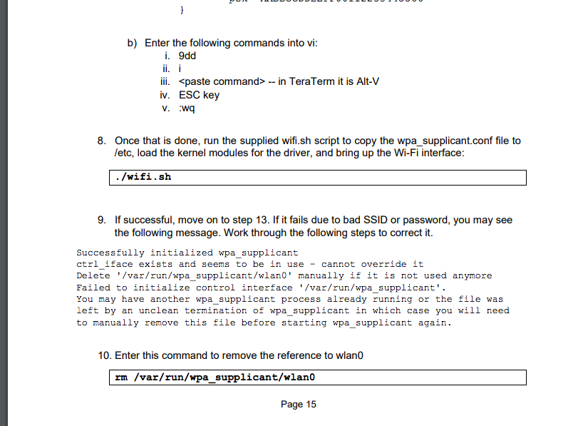

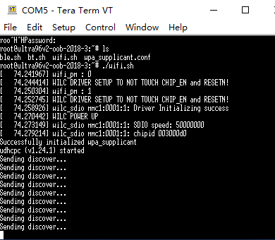

According to GSG, I excute ./wifi.sh, but it displays only "sending discover..." all the time. Did anyone know what's the problem?

    Same thing happened to me.
    Followed the instructions in the Guide.
    I removed the wlan0, re-ran, did not work.
    I rebooted - did not work.
    i killed the wpa_supplicant process ( ps -ef |grep wpa_supplicant).
    Tried other options and so far no luck !
    The unit boots up, I can see the wifi connections of this device, but wont let me login.

    Please check for the obvious. Does the router in question have DHCP enabled? Does DHCP work for another PC or device?
    Is the SSID and password correct?
  • saoniu
    0 saoniu over 7 years ago in reply to clem57
    Excuse me, I'm kind of confused. Shouldn't Ultra96V2 Board be set as the router? And if it works, I can connect to Ultra96V2 with another PC or device through WIFI interface. But now, it seems I failed to set Ultra96V2 as a router, my other wireless device can not find it. In this, how can I enable DHCP?
