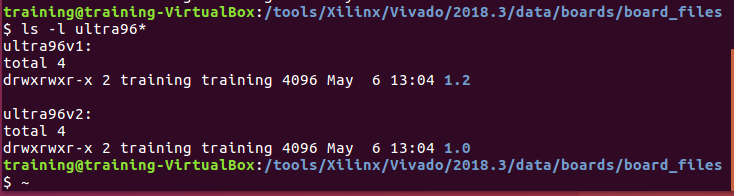

  • bhfletcher
    0 bhfletcher over 7 years ago in reply to miner_tom
    Did you add an extra layer of directory structure into the path by chance? If I go to the board_files directory, I see the ultra96v1 and ultra96v2 directories there. There should not be an Avnet or other vendor directory.
    We also wrote a VirtualBox Install Guide that includes some information and screenshots from installing board definitions near the end. You could check it out for clues as well.
    http://avnet.me/vbox-install-guide
    Bryan
