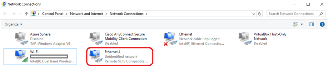

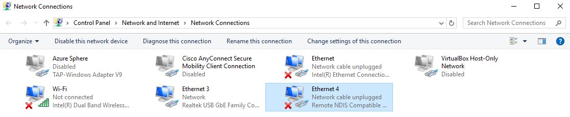

    I tried with my other Windows 10 PC and I ran into some issues getting that USB Gadget connected, specifically the Remote NDIS networking interface was reporting as Network cable unplugged when clearly it was already plugged.
    I have been following this other post and wondered if these could somehow be related?
    Re: Ultra96 and Click Mezzanine unhappy with Ubuntu?
    Sure enough, if I follow this procedure, I can get the Remote NDIS interface to work as expected and access the Jupyter Notebooks on my Ultra96:
    1. Disconnect laptop from my Thunderbolt docking station
    2. Connect to Ultra96 J1 USB 3.0 ULPI Upstream port and wait for the Remote NDIS show Unidentified network as its status
    3. Connect laptop to my Thunderbolt docking station
    Once I complete this particular dance of actions, the Remote NDIS still shows as connected.

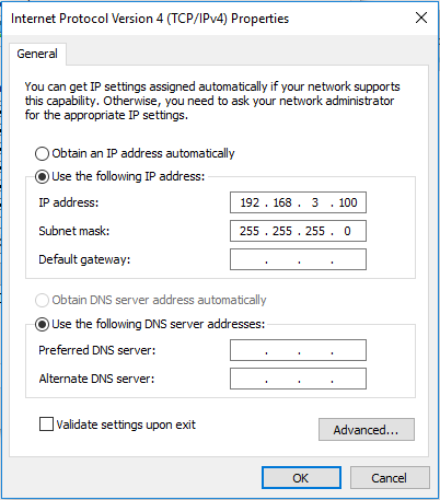

    I then configure my IPv4/TCP properties to set my IP address to 192.168.3.100 with a subnet mask of 255.255.255.0 and I am off and running!

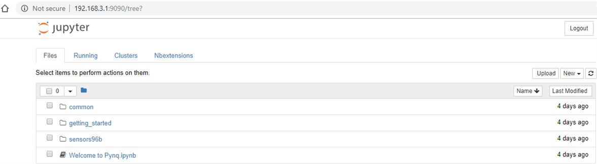

    Then I am able to connect to the Jupyter Notebooks on my Ultra96 by opening the following URL in a browser:
    http://192.168.3.1:9090/
