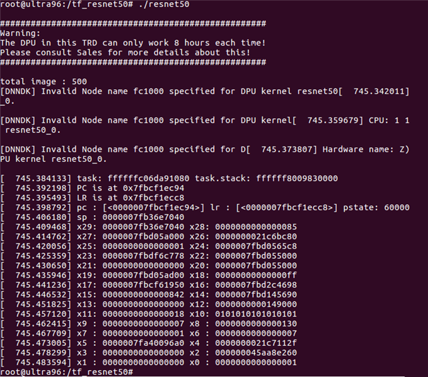

I want to run the resnet50 model(tensorflow version) on Ultra96v2. But when I run the resnet50, it can not work.
The board displays this message:"[DNNDK] Invalid Node name fc1000 specified for DPU kernel resnet50_0."
I do not know where go wrong.
Any help would be greatly appreciated.

    Hello shixiaoke , I know this is a bit late of a reply but have you tried the latest Vitis-AI 1.1 examples on your Utlra96? https://www.hackster.io/AlbertaBeef/vitis-ai-1-1-flow-for-avnet-vitis-platforms…
  • kevinkeryk
    0 kevinkeryk over 6 years ago
    Hello shixiaoke,
    https://www.hackster.io/AlbertaBeef/vitis-ai-1-1-flow-for-avnet-vitis-platforms-part-1-007b0e
    There is one example which uses ResNet50 which may be useful for you?
    Best Regards,
    -Kevin
