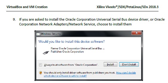

Hello All, I am having trouble getting both my USB to work and my SDK to connect to my ULTRA96-v2 board under the UBUNTU 16.04 LTE VM,
I refer to the following course document:  MPSoC_HW_2018_3_lab_2_v01_u96.pdf
and specifically to LAB 2 Experiment 4,
Page 36, Figure 51 – Select the Xilinx JTAG USB Device in Ubuntu if i click on the USB link as shown i usually get an error message
about the USB already being busy.
Also when i look in the /dev/ Directory i cannot find an ttyUSB1 entry, in fact i don't see
any USB entries at all. I can see under Windows 10 that the JTAG and USB UART has enumerated ...in my machine to USB serial port 10
Then when i try and run the program either in the debugger or just as a run application. i get an error about not being able
to find an A53 processor ..so basically no joy yet !
Has anybody else faced these issues and have any suggestions as to what is going wrong ?

    Did you install the missing cable drivers?  "Cable Drivers are no longer installed by this installer under Linux. See instructions in the Install Missing Cable Drivers section of this document."
    See page 44 of the VirtualBox_Installation_Guide_2018_3_v1_12.pdf for installation instructions.
    Also, were you careful to install Ubuntu 16.04.4 or 16.04.3?  I had a problem when I just installed the the latest LTS version which was 16.04.6 when I did it.  Xilinx is pretty serious about specific OS version compatibility.  The problem occurred in Vivado in one of the later HW labs.

    Sometimes this stuff ends up being harder than it should be. I don't know of an easy way to downgrade minor versions.  I usually just load the version that I want.  You may have done that but if you are not careful and allow the OS to update, it will happily advance you to the next minor version.  If you haven't loaded a specific version before, you need to search for the version that you want in the directory of older versions.  In this case http://old-releases.ubuntu.com/releases/16.04.4/.  You have to wade through all the choices to get the version that you want which in my case was the 64bit desktop.
    Of course, this is not your USB problem.  I did not have USB issues so I'm not sure what your problem is.  Since you can see the USB port in Windows and installed the Ubuntu drivers and cannot see the USB device in Ubuntu, the only thing I can think of is that the USB interface either did not install or is not enabled in VirtualBox.  Do you recall it asking to install drivers during installation of VirtualBox?
    Unfortunately, I am not a VirtualBox expert so maybe others can help.  If you check the settings in your VM do you see a USB controller and is it enabled?  Here is what I have for the VM I am running for a Minized Hackster tutorial:

    In order to use USB2.0 or better, drbarryh  will need an additional download to match the Virtual box version you now have:
    VirtualBox 6.1.4 Oracle VM VirtualBox Extension Pack
    • All supported platforms
    Support for USB 2.0 and USB 3.0 devices, VirtualBox RDP, disk encryption, NVMe and PXE boot for Intel cards. See this chapter from the User Manual
    for an introduction to this Extension Pack. The Extension Pack binaries are released under the VirtualBox Personal Use and Evaluation License (PUEL)
    . Please install the same version extension pack as your installed version of VirtualBox.
