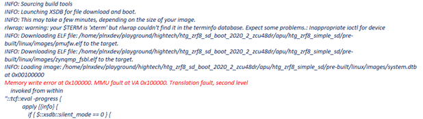

    I have just a similar problem with another board (which is not AVNET) but may be can help you. As you I faced the same problem. when I do " petalinux-boot --jtag xxxx ", it gave me the following output…
  • shredEngineer
    shredEngineer over 4 years ago in reply to quiqueacín +2
    Dear Quique, I just registered to say THANK YOU! I found this solution via Google and this solved the same problem for me, using a Xilinx ZCU111 board . Have a nice weekend! Best regards Pau…
  • quiqueacín
    0 quiqueacín over 5 years ago
    As you I faced the same problem. when I do "petalinux-boot --jtag xxxx", it gave me the following output:
    Which I found very useful is that you can dump (with --tcl ) the xsdb commands to a tcl file which you can source afterwards:
    petalinux-boot  --jtag XXXX --tcl tcl_cmds.tcl

    In my case when I run step by step it worked.  So I finally work it out by increasing the after 4000 time as shown in the following script. There is also code at the beginning to allow jtag booting even without power-off.
    set WAIT_AFTER_FSBL 10000

    Then I run tcl_cmd.tcl as
    /opt/Petalinux/2020.2/tools/xsct/bin/xsdb tcl_cmds.tcl
    Next step will be to generate the script on the fly, or to find if petalinux-boot waits are configurable in any way image
    I hope it helps you.
    connect -url 172.17.0.1:3121
    targets -set -nocase -filter {name =~ "*PSU*"}
    # This is added to allow JTAG boot without reboot
    puts stderr "Resetting system. Just in case"
    rst -system
    after 5000
    mask_write 0xFFCA0038 0x1C0 0x1C0
    targets -set -nocase -filter {name =~ "*MicroBlaze PMU*"}
    puts stderr "INFO: Downloading ELF file: /home/plnxdev/playground/hightech/htg_zrf8_sd_boot_2020_2_zcu48dr/apu/htg_zrf8_simple_sd/pre-built/linux/images/pmufw.elf to the target."
    dow  "/home/plnxdev/playground/hightech/htg_zrf8_sd_boot_2020_2_zcu48dr/apu/htg_zrf8_simple_sd/pre-built/linux/images/pmufw.elf"
    after 2000
    con
    targets -set -nocase -filter {name =~ "*APU*"}
    mwr 0xffff0000 0x14000000
    mask_write 0xFD1A0104 0x501 0x0
    after 5000
    targets -set -nocase -filter {name =~ "*A53*#0"}
    source /home/plnxdev/playground/hightech/htg_zrf8_sd_boot_2020_2_zcu48dr/apu/htg_zrf8_simple_sd/project-spec/hw-description/psu_init.tcl
    puts stderr "INFO: Downloading ELF file: /home/plnxdev/playground/hightech/htg_zrf8_sd_boot_2020_2_zcu48dr/apu/htg_zrf8_simple_sd/pre-built/linux/images/zynqmp_fsbl.elf to the target."
    dow  "/home/plnxdev/playground/hightech/htg_zrf8_sd_boot_2020_2_zcu48dr/apu/htg_zrf8_simple_sd/pre-built/linux/images/zynqmp_fsbl.elf"
    after 2000
    con
    puts stderr "Waiting $WAIT_AFTER_FSBL ms for FSBL"
    after $WAIT_AFTER_FSBL; stop; catch {stop}; psu_ps_pl_isolation_removal; psu_ps_pl_reset_config
    puts stderr "INFO: Loading image: /home/plnxdev/playground/hightech/htg_zrf8_sd_boot_2020_2_zcu48dr/apu/htg_zrf8_simple_sd/pre-built/linux/images/system.dtb at 0x00100000"
    dow -data  "/home/plnxdev/playground/hightech/htg_zrf8_sd_boot_2020_2_zcu48dr/apu/htg_zrf8_simple_sd/pre-built/linux/images/system.dtb" 0x00100000
    after 2000
    puts stderr "INFO: Downloading ELF file: /home/plnxdev/playground/hightech/htg_zrf8_sd_boot_2020_2_zcu48dr/apu/htg_zrf8_simple_sd/pre-built/linux/images/u-boot.elf to the target."
    dow  "/home/plnxdev/playground/hightech/htg_zrf8_sd_boot_2020_2_zcu48dr/apu/htg_zrf8_simple_sd/pre-built/linux/images/u-boot.elf"
    after 2000
    puts stderr "INFO: Downloading ELF file: /home/plnxdev/playground/hightech/htg_zrf8_sd_boot_2020_2_zcu48dr/apu/htg_zrf8_simple_sd/pre-built/linux/images/bl31.elf to the target."
    dow  "/home/plnxdev/playground/hightech/htg_zrf8_sd_boot_2020_2_zcu48dr/apu/htg_zrf8_simple_sd/pre-built/linux/images/bl31.elf"
    after 2000
    con
    exit
    Quique
