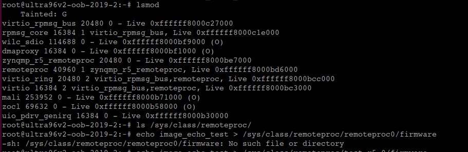

I try to run RTU R5_0 on the board ultra96v2. I successfully created Linux image (used Petalinux 2019.2) based on your example ultra96v2_oob_2019_2 and run it on hardware. However, I do not see anything in folder /sys/class/remoteproc/. There is a list of lsmod command:
What can cause this issue?

    This is a known issue with the Ultra96-V2 BSP.  This used to work in previous BSPs, but unfortunately something has broken.  We are looking to fix this in future BSPs.  We are sorry for the inconvenience.

    Thank you for your response. I fixed this issue. I downloaded ug1186-zynq-openamp-v2019.2.pdf file and updated your openamp.dtsi file based on configuration from this document. It works right now.
