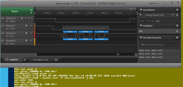

In xlnx kernel version 2018.3 spi work fine on ultra96 LS connector
simple spidev_test -D /dev/spidev0.0 -pAbc  command give expected spi waveform below

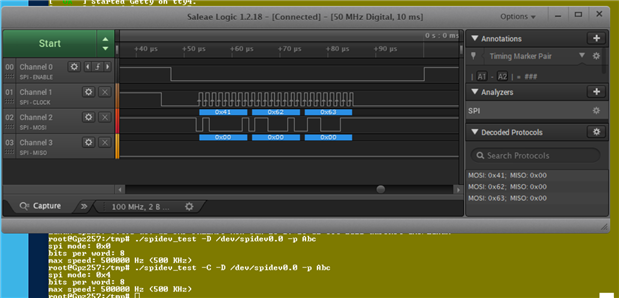

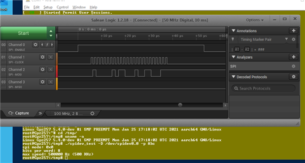

In 2020.1 kernel the CS is not driven the same way
same command give waveform below where cs polarity is obviously wrong
to get same or say expected behavior cs_high must be used that turn cs active low !
command is spidev_test -C -D /dev/spidev0.0 -p Abc
