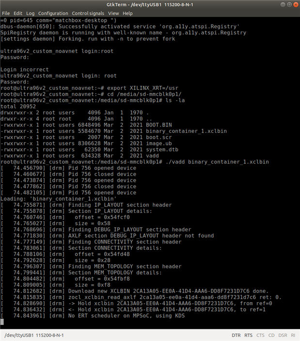

3) In the end when I replicate avnet's image-full on my custom project I get in the end the following error and stuck when running an OpenCL application:
No ERT scheduler on MPSoC, using KDS : How is this possible when I am using the same .xsa as you do and same system_wrapper.bit file?
Attached is the boot.log which has all the information available.
