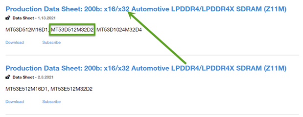

    Coming back to this topic, as I think I have found a way to locate the datasheet, although it is not the way you expect.
    The Ultra96-V2 uses Micron LPDDR4 PN MT53D512M32D2DS-053 AIT:D. This is a 512 meg x 32, 2-die, 535ps, Rev D, IT Temp grade (-40C to 95C) with Automotive Package-level burn-in, in a 200-ball WFBGA package. You can decipher all this from the Part Number Chart on Page 2 of the Datasheet (assuming you can find the datasheet).
    Micron classifies all their parts with Device IDentifications, or DIDs. In this case, the DID is Z11M.
    Now for the interesting game of finding this datasheet on Micron.com.
    1. Make sure you register and log in.
    2. Search for "Z11M" -- that's an eleven in the middle there and not two 'i's
    3. Narrow the Search by Solutions --> Automotive
    4. Further narrow your search with Content Types --> Data Sheets --> Data Sheet
    5. As of today (6 May 2021), that leaves me with two options, with the correct one shown in green.
      • Production Data Sheet: 200b: x16/x32 Automotive LPDDR4/LPDDR4X SDRAM (Z11M), MT53D512M16D1, MT53D512M32D2, MT53D1024M32D4
    For reasons unknown to me, any of the following searches on micron.com will either return the wrong temperature grade or bury the correct datasheet so deep that you will never find it.
    • MT53D512M32D2DS-053 AIT:D
    • MT53D512M32D2DS
    • MT53D512M32D2  --> this one gets you close. The correct datasheet is at the bottom of the page.
