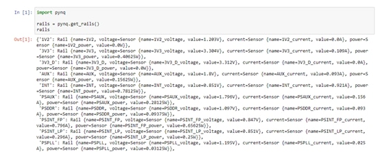

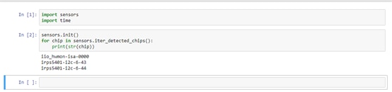

Hi everyone,
I'm a student trying to use DPU+PYNQ v 1.3.0 to deploy some models, when I'm trying to measure the power at [recorder = pynq.DataRecorder(rails["5V"].power)], it didn't work.
I found it's because I couldn't get the sensor ir38060-i2c-6-45(5V).
It seems I have to make changes on both the /etc/sensors.d/ultra96.conf and the BOOT.bin, image.ub to make it work, but I don't know how to make these changes on the PYNQ 2.6 and
make sure the DPU+PYNQ 1.3 work correctly.
I would appreciate it very much, if you can write an answer to it when you are available.
Thanks a lot!
