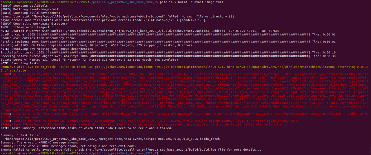

The build process of the "avnet-image-full" fails because of an issue in the bitbake recipe "wilc_15.6.bb":
it looks like the do_fetch cannot complete.

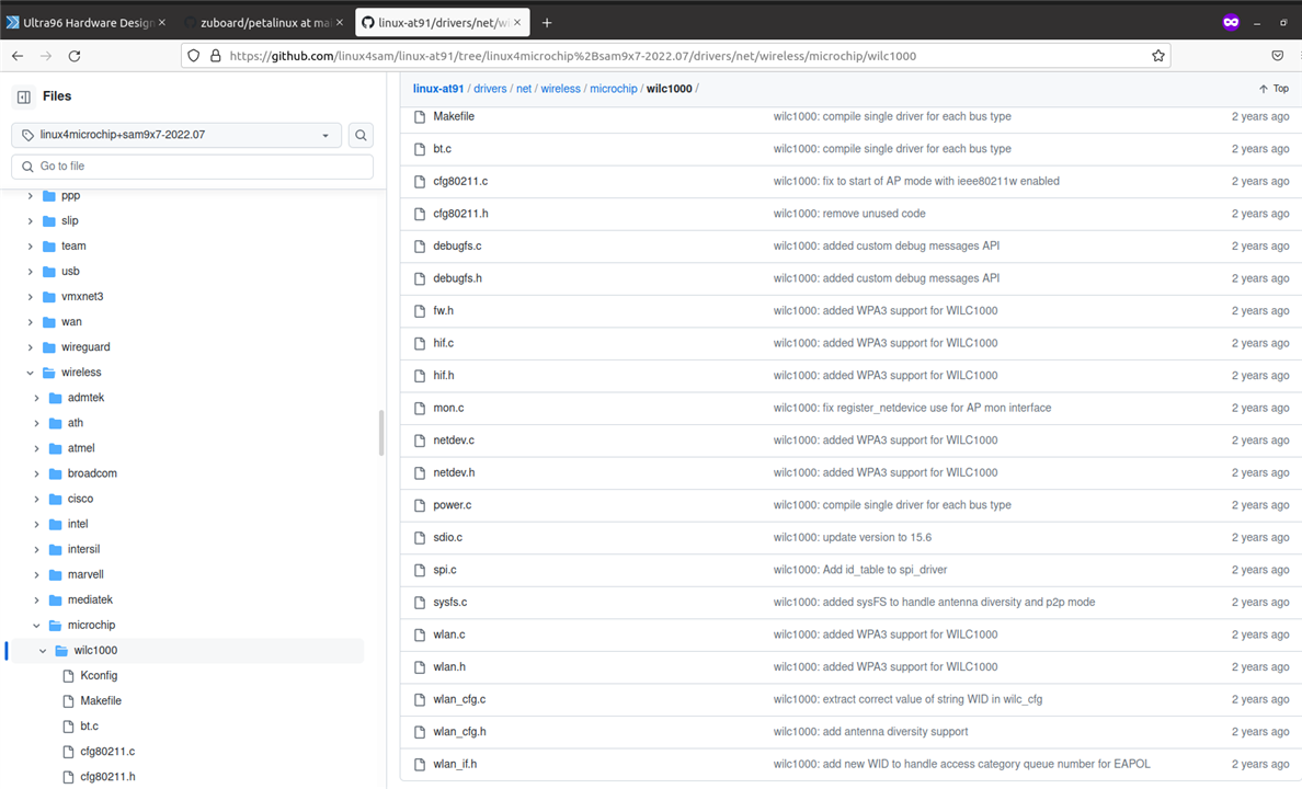

By opening the recipe that is failing:
I can find the link to the git repo from which the source file is downloaded:
git://github.com/linux4sam/linux-at91.git
it seems as if the branch referred in the recipe, as well as the sub-path are there:
so the recipe is pointing to somewhere which sounds still valid.
Could you please advise how to fix the error?
If not, could you please tell me how to exclude the offending bitbake recipe from the builds?
