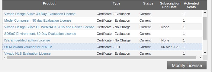

    It seems after I deleted my floating eval license I have been able to generate a new node locked license based on the voucher. There is an entry in the node locked license that starts with "OEM Voucher ...". It is a bit confusing with other entries that also go into the license and are still evaluation. I hope the rest are separate items that can be purchased individually and the OEM entry will override them. Hopefully. I'll report back if the issue hasn't been resolved. I'll try the newly generated node lock license soon.

    What SHOULD happen, is the highest priority license should cover everything that is does - overtop of anything that states eval.  So, even if it says eval for a thing, and that thing is covered by say the "OEM..." license, the item should be licensed.

    In attached screenshot you can see what I have. So should the line "OEM Vivado voucher for ZU7EV" override all the others that say "30-Day Eval" or "60-Day Eval" ?
    I sure hope so. Perhaps this Friday will still turn out well image

    It does not override ALL the evals.  It will override any evals that it is supposed to.  What I meant was that it won't require you to remove licenses.
    For example, Design Edition does not override Model Composer's Evaluation License.
    https://www.xilinx.com/products/design-tools/vivado/integration/model-composer.html
    Under the Download / Buy Tab
    "Model Composer can be purchased as an add-on license to Vivado Design Edition, Vivado System Edition, Vivado WebPACK Edition and VitisTm Development Environment. "
    --Dan

    in your opinion, do you think I have properly redeemed the voucher based on this line in the list (my screenshot):
    OEM Vivado voucher for ZU7EV  ... 6 Mar 2021

    I believe so.  I looked at my machine and actually do not have any licenses to compare, but I do believe that is what you will see.  Depending on the special license, there could be other things - for example when you use a voucher for SDSoC, there are a handful of things that get added.
    However, with this, I do believe it is just the 1 thing.

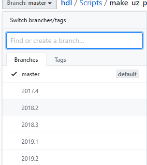

    Make sure to use the correct branch!

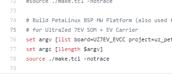

    I'd suggest you try building using the make_uz_petalinux.tcl
    https://github.com/Avnet/hdl/blob/master/Scripts/make_uz_petalinux.tcl
    When you run this, it defaults to building all three UltraZed, you'll want to edit that script to ONLY build the LAST section:
    Comment out everything else.
    Also, make certain you are doing this either in a VM or a supported native linux install.  We have moved away from using Windows native due to the needs for other parts of the Xilinx build.  While the Vivado build MIGHT work under Windows, I cannot say it does as I've not tested this.

    2019.2 is fully supported, or better use 2019.1 ? (I've seen in another thread that 2019.2 will be fully supported by end of the month)

    The 2019.2 branch is in progress.  We are adding Vitis support, so if you are trying to evaluate the tools, use the 2019.1 tools and branch.
    I cannot say the 2019.2 stuff will build as I am not sure what has been checked in at this time.
