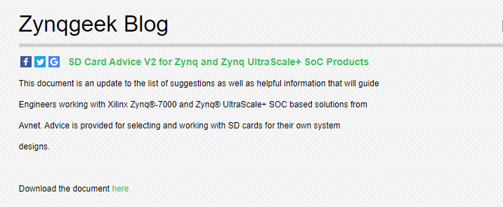

    Hi there,
    If you have not seen this, we have a SDCARD Advice document that might assist you.
    Zynqgeek Blog | Zedboard
    Then download the  V2 document.
    --Dan
