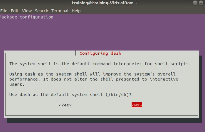

    Hi there,
    Thank you for posting the OS version.  That was going to be my first question.
    While the tools should support CentOS 7.4. 7.5, 7.6 we only officially test our scripting under Ubuntu 18.04.02 at this time. 18.04.1 LTS, 18.04.2 LTS are officially supported by the Xilinx tools and I think one team member is still on 18.04.01 - but that is not where the tags will be built from.
    https://www.xilinx.com/html_docs/xilinx2020_1/vitis_doc/aqm1532064088764.html
    We also only support BASH, which can be seen from our VirtualBox installation documentation.  You can ignore the VM portions and take a look at the OS configuration sections and translate that over to CentOS, or the more painful option since you are setup with CentOS, use Ubuntu.
    Here is a link to that document: http://avnet.me/vm_install
    Just off the top of my head, I have seen similar strange things with our build scripting when you use DASH instead of BASH.  I am not sure what the default is for Cent.  Check that and see if that help you.
    In Ubuntu, you would type:
    sudo dpkg-reconfigure dash
    Then select "no"
    ** Note that this reconfigure is different than just assigning a new shell using something like chsh and the above command is the one that works under Ubuntu
    This link might also help, there are solutions for switching without using dpkg-reconfigure for OS that are not Ubuntu: https://unix.stackexchange.com/questions/442510/how-to-use-bash-for-sh-in-ubuntu
