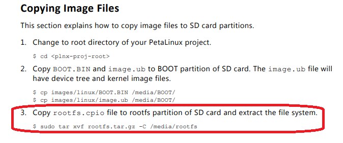

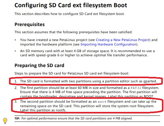

    0 khabnl over 7 years ago in reply to zedhed
    Hi Kevin,
    Because our team switched to VV2019.1 for zynq ultrascal+ platform that's why I test with the latest petalinux,
    But it's Okay test with petalinux 2018.2.
    I download the uz7ev_evcc_sd_oob_2018_2.bsp file for UltrascalZed-EV board test.
    I did test two step:
    step 1 is no external rootfs    : booting fine
    step 2 is with external rootfs  : end Kernel panic - not syncing: VFS: Unable to mount root fs on unknown-block(179,10)
    My application is always configured to Root filesystem type -> SC card.

    Step 2 BSP test for rootfs booting from Ext4:
    1) petalinux-config
       Change Image Packaging Configuration -> Root filesystem type -> SC card
    2) petalinux-build
    3) petalinux-package --boot --format BIN --fsbl images/linux/zynqmp_fsbl.elf --u-boot images/linux/u-boot.elf --pmufw images/linux/pmufw.elf --fpga images/linux/system.bit --force
    4) Copy BOOT.bin and image.ub to SD card
    5) SD card booting message

  • zedhed
    0 zedhed over 7 years ago in reply to khabnl
    Hi Kiman,
    Thanks for posting the steps you followed, that makes it much easier to understand where you are getting stuck.
    I do not see any instructions that you've listed for extracting the ROOTFS to the external file system.  Usually, this is done by creating a second EXT4 partition on the SD card like this:
    Once you have the second partition in place, you can extract the packed ROOTFS tarball from PetaLinux to this partition.  When Linux boots on UltraZed, it will attempt to mount the EXT4 partition on the SD card and use its contents as the persistent root filesystem.
    Further details are available for you in the Xilinx UG1144 reference guide:
    https://www.xilinx.com/support/documentation/sw_manuals/xilinx2018_2/ug1144-petalinux-tools-reference-guide.pdf
    Best Regards,
    -Kevin

  • khabnl
    Hi Kevin,
    >>So your bootargs from PetaLinux were being overridden by ones kept in persistent NVM storage for U-Boot?
    I think yes, but not sure! see below message from U-Boot console.
    U-Boot 2018.01 (Jul 23 2019 - 12:06:10 -0400) Xilinx ZynqMP ZCU102 rev1.0
    ZynqMP> setenv bootargs 'earlycon clk_ignore_unused root=/dev/mmcblk1p2 rw rootwait'
    ZynqMP> env save
