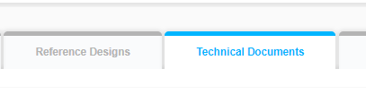

    For the Design Guide, head to the UltraZed-EG Product Page:
    UltraZed-EG
    Click on Technical Documents,
    then download the guide
    As for specifics to the amount of skew, I'm not sure I can answer that.  You can check the BDF configuration that we provide in our repository, as well as compare against the trace lengths that we have for the UltraZed Carriers + SOM + Package.
