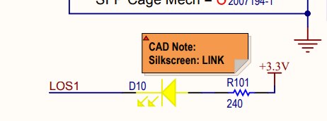

Hi,
I am trying to enable the SFP+ interface 1 by connecting it by RJ45 to SFP+ converter and run the XIlinx echo server on it.
In my Vivado design, I used the AXI 1G/2.5G Ethernet subsystem with the GT reference clock set to 125mhz and GT location set to X0Y4.  For the 125mhz clock, I routed from pins B10 and B9 from the board.  The SFP+ rates are left at the default settings.  The D10 LED is lit up when the RJ45 is connected via SFP+ converter to the SFP+ 1 cage.
Unfortunately the echo server program stops after the lwip_init() function and cannot proceed further. Thus the board is not assigned any IP address.

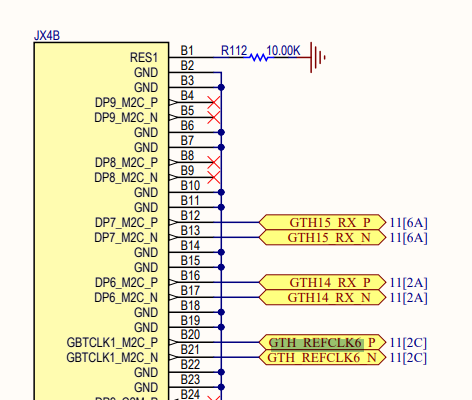

    Could you tell me what are the frequencies for GT_REFCLK4 and GT_REFCLK6?  I'm trying to see if these can be used for the SFP interfaces.
    I can't find it anywhere in the documentation.
    Thank you and regards,
    Li Chia
  • drozwood90
    0 drozwood90 over 6 years ago in reply to clc1717el14
    Hi there,
    If you reference the schematic for the SOM and CC, you will see that those two clock inputs come from the FMC connector:
    Schematic Page 9
    --Dan

    Hi there,
    Please check these:
    Is the D10 LOS LED on or off?
    JP6 should be placed
    Rate Sel Jumpers are defined based on your SFP module
    Any configuration or other "needed" configurations will need to be programmed into the SFP module over the I2C link
    Personally, I have a non-protocol SFP Loopback adapter.  It internally loops back.  No cabling.
    I've used that with the PicoZed to test performance.
    Typically a module is "dumb" and just pushes BITS as they come in.  This is why if you wanted to run 10/100base-t you could by just repeating bits or decimating incoming bits.
    But everything you are describing, as far as I can tell from only what you said, seems to me that you don't have link, or if you do, the transmitter is disabled for some reason.  Just to try it, you could attempt to remove JP6 to see if the module has the wrong logic, but seems everything is in order INSIDE the fabric.
    --Dan
  • clc1717el14
    0 clc1717el14 over 6 years ago in reply to drozwood90
    Hi Dan,
    Thank you for your reply.
    I checked and verified the following.
    1) D10 LOS LED is on.  IBERT reports no link.
    2) JP6 is placed.  IBERT reports no link.
    3) When I remove JP6, the D10 LOS LED is still on, there is a link with near-end PCS and near-end PMA, but no link with the 10G SFP+ loopback module..
    I am using 10G SFP+ loopback module.    I like to confirm with you on the rate selection.  The jumpers can be used to configure the rates of 2.125, 4.25 or 8.5 Gbps, according to the hardware user guide.  Since I am using a 10G SFP+, does it mean that if I set up the IBERT at any of the 2.125, 4.25 or 8.5Gbps protocols, there will be no link?  Do I then have to set up the I2C to configure a 10Gbps link?
    Sorry for the silly question, as this does not make sense.  As you have mentioned,  we should be able to send at lower rates over a 10Gbps link as the SFP+ module is dumb.
    Thank you and best regards,
    Li Chia
