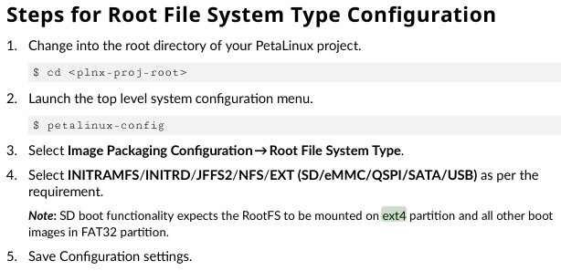

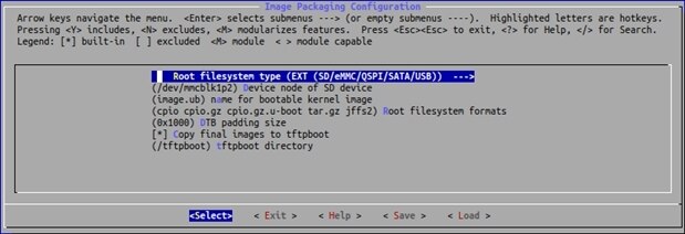

    To mount a Ubuntu rootfs at boot you need to be sure to modify the PetaLinux config.  This is described in Xilinx UG1144 (https://www.xilinx.com/support/documentation/sw_manuals/xilinx2019_2/ug1144-petalinux-tools-reference-guide.pdf ):

    Generally speaking, and especially in your case of using an Ubuntu rootfs, unless you know you need to add a kernel driver module or change any kernel config settings you can skip 'petalinux-config -c kernel'.  You can run 'petalinux-build' right after importing the hardware description, making any necessary changes to the device tree (<project>/project-spec/meta-user/recipes-bsp/device-tree/files/system-user.dtsi), and making any necessary changes to the boot options, etc. ('petalinux-config').
