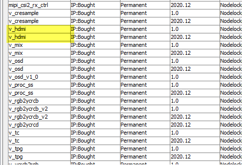

    Ralph,
    We used to ship licenses for "Design" Edition as that was the only way to use the 7EV MPSoC.  Once Xilinx moved that SoC into what I would call "WebPack" we stopped including that license.  And actually, since the time when Xilinx did that, running the DisplayPort design just now is the first time I ran into a license issue (again, not installing licenses on my machine).  Also, it seems that the QuickStart card was never updated.  I've noted that.  I currently run 2020.1 Vitis install (Vivado / Vitis) on my Windows Machine for validation and quick tests.  I never installed a license, as I try to mimic what customers might be doing and it is hard to see that when you install a full up developer license or one of the other "give you every feature" license.  Regardless, on my windows machine, I was able to create a Vivado output using the Xilinx ZCU106_hdmirx design from the VCU TRD without issue. Extract, run script, check for output.  Please MIND the path length...that can cause you issues under Windows.
    Suspecting the PL DisplayPort IP block being another question you might have, I then tried a similar design with a DisplayPort IP Block and that failed.

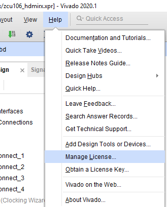

    If you pull up licenses manager you can see all the licenses you have.
    easiest way is open Vivado, then under "Help" --> "Manage License..."
    As you can see I do not have a v_dp (the name of the license for the PL DisplayPort), but I do have the v_hdmi, which I did not add to my machine.
    So, I believe you are good. If you do have issues with it, please reach out to the administrator and we'll get you sorted as you should not have to struggle with a license for a roadtest.

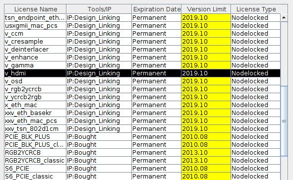

    0 ralphjy over 6 years ago in reply to drozwood90
    Dan,
    I learn something useful everyday image.   There are so many license variants that it's hard to keep track.  I see for the PL DisplayPort that there is a dp and v_dp license.  I am using the PS GTR implementation of the DisplayPort so haven't run into any issues there although I do see that as you mentioned that I don't have either the dp or v_dp license.  I do have the v_hdmi license but it's listed as "DesignLinking" so I'll try that hdmirx design in Vivado to make sure I don't have any issues.  It's possible I may not be able to write the bitstream if this is a simulation only license.   I notice that your license is listed as "bought".   I have to admit I don't pay much attention to licenses unless something doesn't work.

    Ralph,
    Yes, licensing can get complex fast!
    Look at the version of your tools.  See that I am on 2020.1, you look to be on 2019.1  That's likely the difference we are seeing in the HDMI.  And yes, you do NOT need a license for the PS GTR based DisplayPort.  That comes "free" as the "fee" is covered in buying the chip.  The same goes for any of the other PS blocks and the VCU.  It is also why using the VCU IP blocks in Vivado fails unless you choose a VCU capable chip.  While you COULD use the VCU DDR controller, the tool (last I checked) would not allow it without having a VCU capable chip selected.

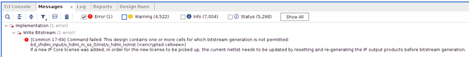

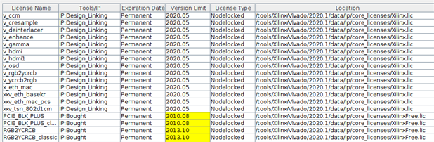

    Hi Dan,
    Thought I'd give you an update.  It took me a while to get the 2020.1 tools loaded, but I did verify that I still only have the limited licenses.  I think you've got something extra in your setup that gives you these licenses.  Also not sure why my Version Limit shows up as 2020.05 while yours are 2020.12 and 1.0.
    I also did verify using the hdmirx design with the 2019.2 tools that my interpretation of "Design_Linking" is correct.  I can work with the design in Vivado but I can't write the bitstream.  I think this is probably what the other roadtester encountered.
    I'm pretty late in the roadtest (deadline is August 30) so I think that I won't bother asking Randall for a license.  I really would have liked to try out these other elements and use them for my project but I may need to simplify my project to complete in the roadtest window so I wouldn't be able to justify asking for the license in that context.   I really appreciate the opportunity to work with this hardware.  It's a great collection of hardware but working through the tools and version issues consume a lot of the roadtest window.  I hope that I'll be able to get a lot more done post roadtest.  I'm glad that the VCU doesn't require a license as that was my primary interest in this roadtest.
