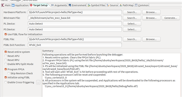

Hello, I was working with Ultrazed fine. i could modify the avnet base proyect, execute in baremetal some examples ("hello world", my own examples with Video Test Pattern Generator,etc),
Yesterday i start to have problems using the board.
So i tried to work with SD card that used weeks before (and i was working).If i switch to start with SD, the FPGA doesnt program(led blue off).
If i program the FPGA with JTAG the LED turns blue ( programmed) but i cannot execute a "hello world" example. It says:

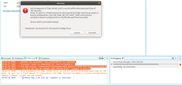

09:02:28 INFO : The application '/home/ubuntu/workspace/2020_BASE/ultrazed_base/export/ultrazed_base/sw/ultrazed_base/boot/fsbl.elf' is downloaded to processor 'psu_cortexa53_0'.
09:02:28 INFO : 'set bp_2_28_fsbl_bp [bpadd -addr &XFsbl_Exit]' command is executed.
09:03:28 WARN : Exit breakpoint of FSBL (XFsbl_Exit) is not hit within allocated wait time of '60' seconds.
Note: To wait for a fixed amount of time specify the FSBL function as empty in launch configuration. Use 'IDE_FSBL_BP_HIT_WAIT_TIME' environment variable in launch configuration to modify the wait time (seconds).
Reason: timeout: target has not halted
09:03:28 INFO : 'bpremove $bp_2_28_fsbl_bp' command is executed.

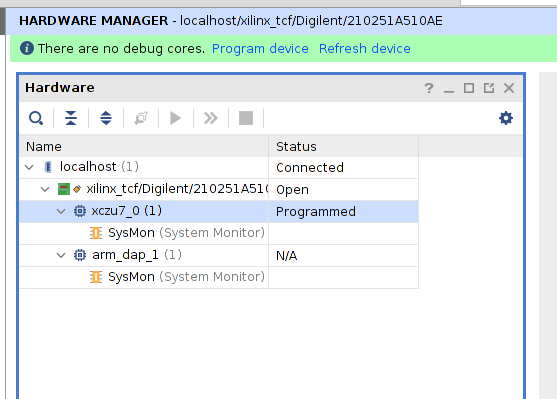

Im using the base prject's bitstream. (I was using it really well the days before).
Vivado detect the FPGA (and i can programm it also):
I really dont know what to do. I change USB cables, reset PC, its very weird. I have  JP1,JP2,JP3 OFF  IN ULTRAZED EV SOM ( NO jumper), JP20 (of CC)  in 2,3
I think the problem is in the processor .

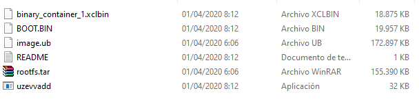

    Yes, im using the SanDisk 16GB in FAT32 mode and this structure:
    I want to clarify again that in SD Card mode the LED of FPGA is off. I use this SD Card mode a month ago and it works, but now is not working .
    The same for JTAG mode but i can program the FPGA so LED is on, but the Cortex is "dead" or not working.
