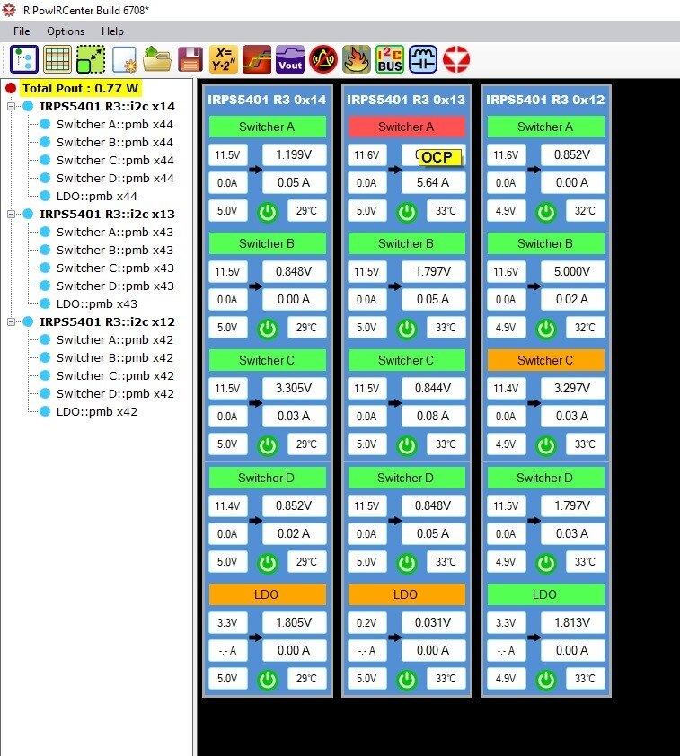

I'm using an UltraZed 3EG SOM on a custom baseboard modeled on the IOCC which has been extensively tested with multiple SOMs.  We had successfully programmed the QSPI and eMMC with our software and powered on and off several times.  Then upon one power up, only the red D4 LED (for POR) was lit, and I also thought I saw some smoke from end of the SOM where D3 and D4 are.  On my baseboard, I still have a PG light on from the SOM.  On further investigation with my IRPS dongle, Output A on U19 (one of the SOM power supplies) is disabled because of an overcurrent condition (see attached).  Output A provides the VCCO_PSIO net at 1.8V, which powers the VCCO_PSIO core in the Zynq, as well as QSPI chips and a few other things. All the other IRPS outputs look okay.  When this happened, I remembered that several months ago, we had brand new SOM that had never worked, and the POR light was always on.  I then pulled it out today and checked with the IRPS dongle, and sure enough, the exact same thing.  So potentially seeing the same issue on two SOMs.  I tested this baseboard with a previously working SOM and everything is working okay, so I think the issue is on the SOM, not the baseboard.

    Chris, the PSIO rail that failed is the one on the SOM, not the carrier.  It is the IRPS located at address 0x13 in the screenshot in my first post, and it doesn't power anything on the carrier board. It corresponds to U19 on the Ultrazed-EG SOM. From the SOM schematic, it looks like it powers the QSPI and the Ethernet PHY on the SOM, along with a few other minor things.  I believe it also provides the 1.8V for VCCO_PSAUX,VCCO_PSIO_500, and VCCO_ PSIO_503 for the UltraScale+.
    My carrier board is fully functional when I put a different SOM on it, so I think the issue is with this specific SOM.  All of my carrier hardware is powered from the IRPS power supply labeled 0x12 in the screenshot.

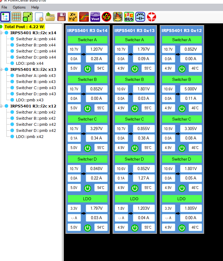

    Here is the PowIR screenshot with a functional SOM attached to the carrier board.

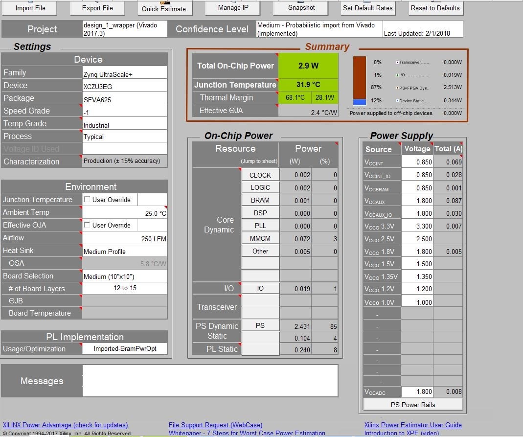

    Apologies, I got the rails mixed up and forgot this one did not get passed to the carrier. Nothing is jumping out at me so please let me look into this a little further. Out of curiosity, have you created an XPE for your design? I'd like to see what the expected current draw for the Zynq would be for your design.

    I do have an XPE that was just an initial shot at it during the hardware design phase. I'm not sure how to upload it here so you can see it.  But here's a shot of the front page with the summary, anyways.image
