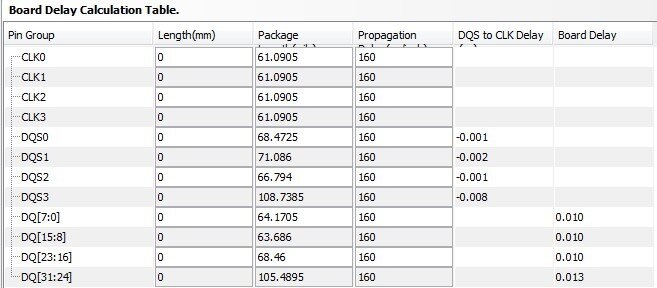

    I understand the case for using the ZEDboard constants for DDR3 worksheet calculations, but wanted to understand a little better where these numbers were obtained.
    In the HW user's guide Table 2 shows the Package Length values. I can't get these - partgen and it's Vivado equivalent don't show the length but the flight time only. For example, for DQS0 I get a mean time of ~67.6ps trace delay. For 160ps/mil this is 422mils, while the table gives 504.
    How were the table package length values calculated? What is their source?

    When Zynq was first supported in the Xilinx tools, the DDR3 parameters were calculated using an Excel spreadsheet that was included as part of Answer Record 46778. The 504 mils listed for DQS0 was what Xilinx had listed at the time (June 2012). I'm not sure if this was an inaccuracy in the spreadsheet or if the package flight times were refined after that time with additional characterization.
    In terms of the Zynq PS DDR3 properly working, having a slightly inaccurate value causes no harm as the silicon is going to calibrate the controller once it comes up. These delay values just need to be close to give the calibration unit a place to start. Incidentally, if you look in a Vivado 2014.2 block design for ZedBoard, DQS0 now shows a Package delay of 68.4725 ps. Is this the Max that you are seeing? I'm not sure why Xilinx would use the Max rather than the mean of Max and Min.
    In terms of trace length matching your own PCB with Zynq, you should use the latest values available through a Vivado package report.

    Yes, my tool - Vivado 2014.x - is telling me that the max delay is ~68ps, which represents a shorter package length than what's quoted in the table of the user's guide. I guess the user's guide quotes older numbers, but as you said it's not a huge deal.
    Thanks for your help and reply!
