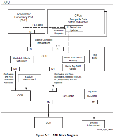

Hi,
I executed an application that writes 8KB of data on OCM, DDR and BRAM for 2 Mega times (for each memory I wrote 16GB totally). I expected different memory speeds for OCM, DDR and BRAM but to my surprise all of these actions were done at the same time. I am using the memset() function for writing 8KB buffers. Anybody can explain it?
-Mohammad
  • zedhed
    0 zedhed over 11 years ago
    Hi Mohammad,
    Are you writing over the same 8KB buffer space successively?
    According to UG585, Zynq has "32KB instruction and 32KB data L1 caches with parity per MPCore" and according to the APU block diagram, the cache coherent trascations with OCM, DDR, and the System Interconnect have to go through the Snoop Control Unit.  If you expand the buffer size beyond 8KB, do you see a difference in performance between these different memories?
    Source:  http://www.xilinx.com/support/documentation/user_guides/ug585-Zynq-7000-TRM.pdf

    Hi Kevin,
    I checked my code and found a mistake there then correct it.
    Now it is demonstrated that writing on the BRAM is much slower than writing on the DDR or OCM but writing on these two are performing with the same speed. Although I expected higher speed for OCM (Do you agree?!). I can not understand why!
    Mohammad
