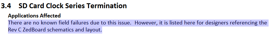

I firstly contacted with Mathworks for this reason and it turned out, my ZedBoard Rev.C has also some hardware issues with itself. After reading the ZedBoard errata Rev.C, I did a hardware fix on USB-UART interface, but there is another issue for "SD Card Clock Series Termination", a 40 Ohm to 60 Ohm resistor in series needed on SDIO clock pin. I do not think I can fix it by my side. So this issue of SDIO clock pin will not be fixed.
My quesition or consideration: by downloading the bitstreams and by running external simulation, the SD card will be written too. So could the SDIO clock issue be a big problem by ZedBoard Rev. C, that the reading or writting files from SD card sometimes corruptted.

    As stated in the ZedBoard Rev C1 Errata:
    Unless you're observing signal integrity problems resulting in corrpupt data, the only action is to design your board with the termination resistor.
