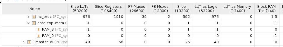

Hello!
We are currently working on a project which requires us to extend a previously created memory interface on a ZedBoard from being 4k in size to 256k (A 1/4 of a MB).
We had previously created a file, called pocket_core_top_mem.v which instantiated a 4k long memory (4 xilinx_tdpram_1024x36 modules) that has been working for the longest time. This old interface used only 4 blocks of 140 available Block RAM modules on the zedboard for the project (50 blocks are used elsewhere, leaving 86 remaining).
Fullscreen pocket_core_top_mem.v.txt Download

While doing this, we simply started by trying to nest multiple memory files (using xilinx_tdpram_1024x36 modules), where we would have a .v file and module for 16k ram (4 4k modules), a file for 64k ram (4 16k modules), and finally a top file which consisted of 4 64k modules. (called pocket_core_mem_16k.v, pocket_core_mem_64k.v, and pocket_core_top_mem_nested.v here).
Fullscreen pocket_core_mem_16k.v.txt Download

Unfortunately, when we went to build the project, it ran through with no errors and wrote the bitstream but unfortunately only 2 RAM blocks were instantiated in the implemented design and I was only able to read and write to 0x100 of the memory space I programmed in. In Vivado, it was only reporting that 51 of the 140 RAM blocks were instantiated.
So, I then created and ran a simulation in Icarus Verilog on my files to see if I could indeed read and write to the higher address blocks. This simulation worked and proved my files didn't have a design error.
I was dumbstruck and thought it was how Vivado interpreted my file methodology that was making the error occur. So, I then simply made a single file (named pocket_core_top_mem_single.v here) with 64 xilinx_tdpram_1024x36 modules in it.
This STILL only had 2 RAM blocks instantiated when Vivado finished building and writing the bitstream:
I also ran simulations to confirm if this file worked or not, and they confirmed the file worked.
pocket_core_top_mem_single.v.txt
Would there be anything that could be preventing Vivado from instantiating these 64 BRAM blocks that I may have missed?
