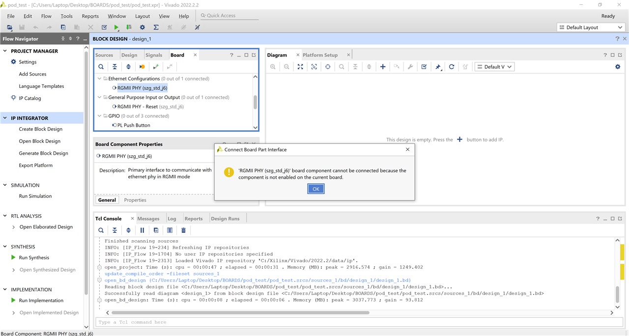

I've added the OpalKelly Ethernet pod (SZG-ENET1G) to the Zuboard 1CG when I created a new project. However, when I go to the block design and attempt to add the "RGMII PHY" in the "Board" tab I get a "component is not enabled on the current board" error. And just as a test, I tried it with a few other pods but it happens consistently with them as well. Any ideas?

    I haven't been able to find any resources on how to use the board files for SYZYGY pods in a meaningful way from the block design. However, I did find a tutorial for using the szg-enet1g with Opal Kelly's XEM8320 here...
    docs.opalkelly.com/.../
    It looks like they provide a custom IP to use it based off AMDs implementation.
    https://github.com/opalkelly-opensource/design-resources/tree/main/ExampleProjects/EthernetExampleDesign/XEM8320
    So it appears you have to use their custom TCL file to add the board and it's components to your project.
    I was really hoping that the board files would be directly usable from block design but that doesn't appear to be the case. It just seems strange for Opal Kelly to provide them but they're not usable.
    Am I missing something? Is it possible to use a Syzygy board file to extend a block design? Thanks!
