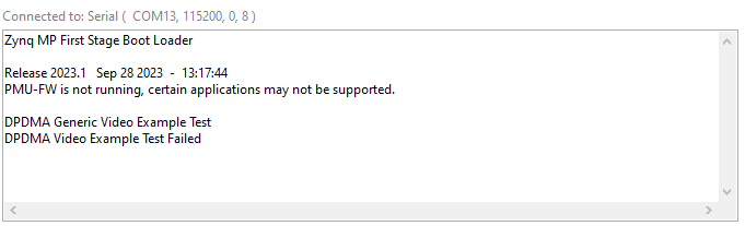

Hi,
I'm trying to run xdpdma reference example from Vitis 2023.1 in a ZUBoard1CG with a DPEMMC module connected to J2 High Speed Expansion Connector. The block diagram just include a single zynq ultrascale mpsoc IP, with enabled Display Port configured as follow:
After generating the bitstream and exporting the platform, i created a standalone application in Vitis 2023.1 by importing the xdpdma_video_example into workspace. However, when i try to run this example, the test fails, showing the following messages:
The problem seems to be related to the initialization of the DisplayPort TX core (XDpPsu_InitializeTx). Does any of you have any idea about which is the problem?. It is possible to get a standalone reference design from Avnet for successfully integrate the DPEMMC module with ZUBoard1CG board?. It is very frustrating to buy a module with such a poor support as this, with just a brief description and an schematic. Any help will be appreciated. Thanks

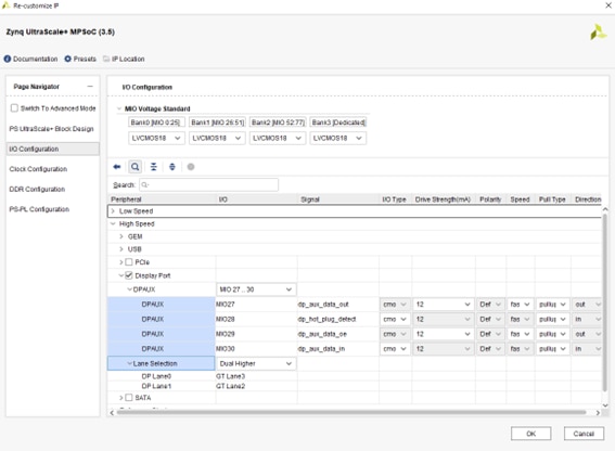

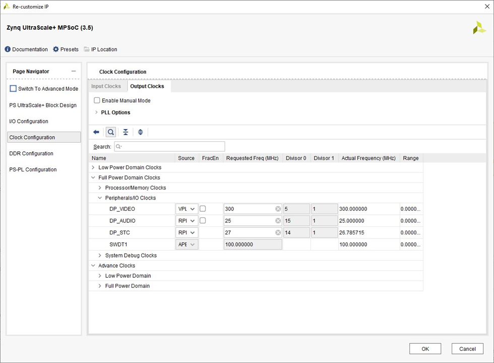

    So I have tried to get it working with the DPPsuDMA example in Vitis and it keeps failing training on different displays, different cables, and lower lane rates...
    I used this config in the block diagram:
    # Enable DisplayPort using PS GTR0 and GTR1
    set_property -dict [list \
    CONFIG.PSU__DPAUX__PERIPHERAL__IO {MIO 27 .. 30} \
    CONFIG.PSU__DP__LANE_SEL {Dual Lower} \
    CONFIG.PSU__DISPLAYPORT__PERIPHERAL__ENABLE {1}] [get_bd_cells zynq_ultra_ps_e_0]
    # Set the DisplayPort reference clock to 135 MHz
    CONFIG.PSU__DP__REF_CLK_SEL {Ref Clk0} \
    CONFIG.PSU__DP__REF_CLK_FREQ {135}] [get_bd_cells zynq_ultra_ps_e_0]
    Here is the output in the UART.

  • narrucmot
    0 narrucmot over 3 years ago
    Your ZynqMP PS GTR, DPAUX, and RefClk settings look correct.  I see on the Xilinx support forums a user had a similar issue as this and found the solution was a change in the Vitis BSP settings.
    https://support.xilinx.com/s/question/0D52E00006iHmXiSAK/standalone-displayport-on-zcu102?language=en_US

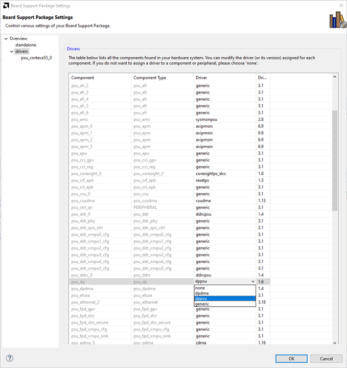

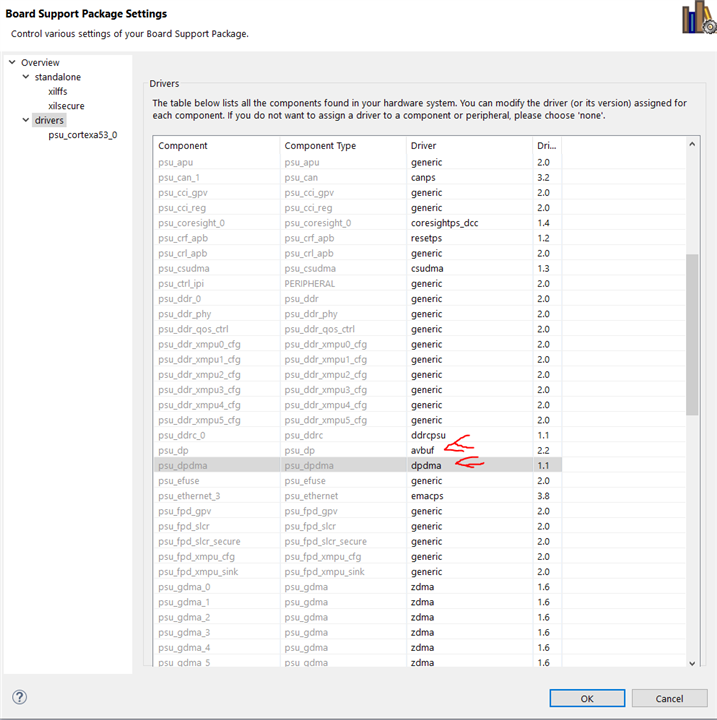

  • flyingbean
    0 flyingbean over 3 years ago in reply to fbt
    Try this configuration at BSP for DP example api:
  • fbt
    0 fbt over 3 years ago in reply to flyingbean
    Hi flyingbean , thanks a lot for your answer. The avbuf option is not available from Vitis 2023.1, as you can see:
    In addition, for live video = 0 and memory to datapath configuration for DP Tx, as i consider it is applicable for this particular case, it is supposed that dppsu driver must be selected, right?. Witing for your reply. Thanks!.
  • fbt
    0 fbt over 3 years ago in reply to narrucmot
    Hi narrucmot , thanks also for your reply. In my BSP configuration i had already selected the driver dppsu for component psu_dp, but the screen is still blank. I hope it will be possible to find any other option to solve the reported problem. Thanks!

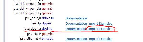

  • flyingbean
    Just for clarification of the demo source codes here.
    1. BSP configuration of yours was right.
    2. Here is the example codes of psu_dpdma(I think you did right work too):
    3. You might need to reconfigure the Video format at the source codes as this:
