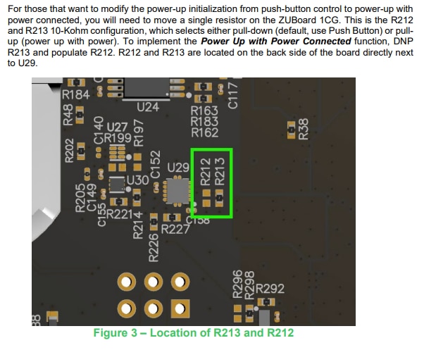

We are trying to set up the “Power Up with Power Connected” feature by swapping out the resistors to avoid having to use a push button, as listed in the Hardware User manual guide:
We have performed this change on our devboard, but it still requires the push button to be pressed in order for the board to boot.
Please advise us on how we could fix this issue.

EDIT: The proposed change by narrucmot seems to have fixed our issue.

    Unfortunately, this is a known issue with ZUBoard. The workaround is to install a resistor and capacitor to create R-C delay at power on. We recommend installing a 200K resistor at R212 and a 4.7uf capacitor…

    Unfortunately, this is a known issue with ZUBoard.  The workaround is to install a resistor and capacitor to create R-C delay at power on.  We recommend installing a 200K resistor at R212 and a 4.7uf capacitor at R213.  This provides a 940ms delay and is enough to allow for powering the board when plugging in the power cable and no need for pressing the power switch.
