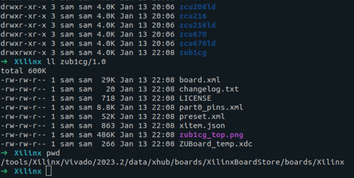

I tried copying the board files manually to the location /tools/Xilinx/Vivado/2023.2/data/xhub/boards/XilinxBoardStore/boards/Xilinx which I got from  https://github.com/Xilinx/XilinxBoardStore/tree/2022.2/boards/Avnet/zub1cg/1.0
b
ut I am still getting the same result.

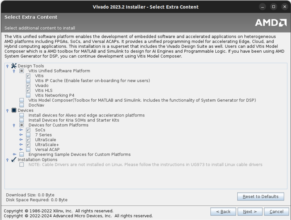

    dyessgg over 2 years ago in reply to e14 Contributor +1 verified
    Try including SoCs since the Zynq MPSoC is an SoC.

    I found an AVNET repository on github and followed the steps suggested there. It suggestes a different path - /tools/Xilinx/Vivado/[version]/data/boards/board_files.
    I copied all the board files to the location, after that it showed entry for auboard15p/1.0 but it did not list zub1cg !!
    So obviously the steps suggested in the repo is correct but somehow it doesn't work for all the boards.

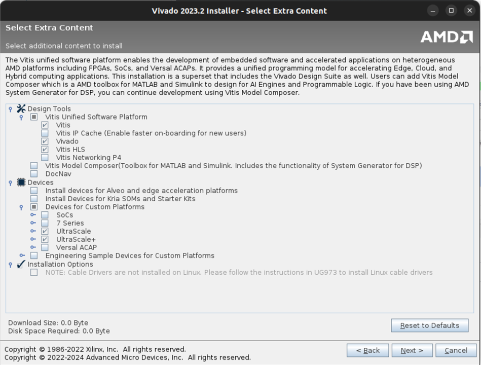

    I am wondering If I have missed something during Vitis installation. Can you look take a look at the screenshot below and let me know if I have missed something -

    0 dyessgg over 2 years ago in reply to e14 Contributor

    0 e14 Contributor over 2 years ago in reply to dyessgg
    YES!! including SoCs worked for me. Thanks for the suggestion dyessgg
    Now I feel I should have asked about the installation configuration in the first place. Expressionless
    Thanks everyone for the help.
