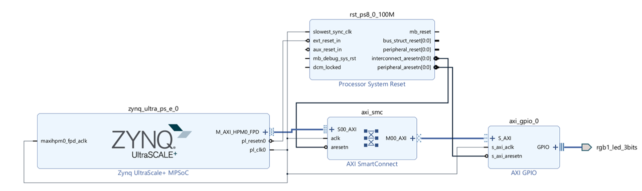

I've setup a minimal project in Vivado, basically I only have the a GPIO block connected to one of the RGB LEDs on the board:
Next, I tried modifying an example code so I can toggle the LED, but once I execute a command that tried reading or writing to the PL side (AXI?) the debugging halts and I must stop debugging to reset the system. The hardware export from Vivado includes the bit file.
Here is the code that I'm running, it will hang on: XGpio_SetDataDirection(&Gpio, 1, 0);
I'll appreciate it greatly if anyone could point out what's wrong here. I'm using the latest Vivado & Vitis.
